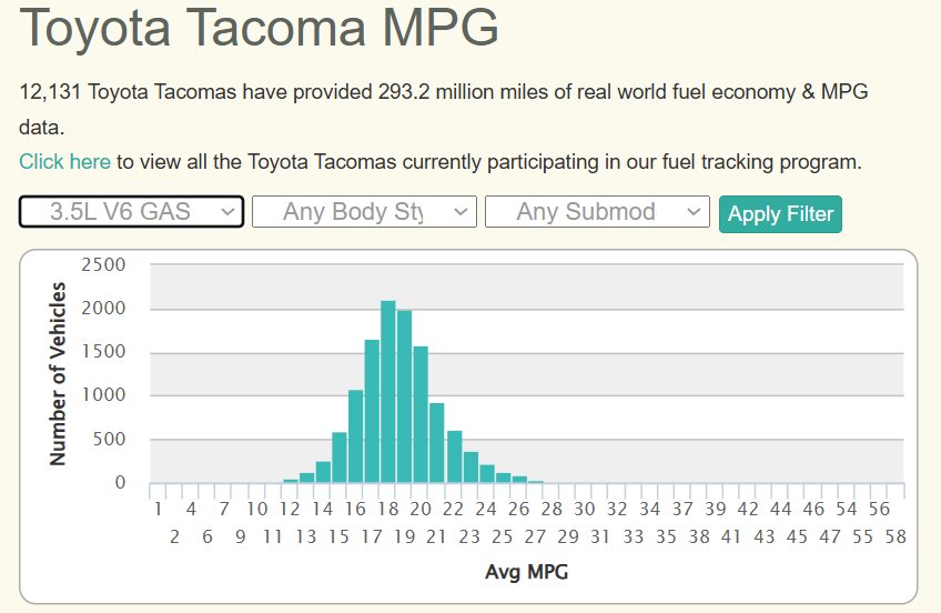

    Yea I did buy it in August, so it was hot, now it's January it is cold. I am in the deep south of the US. I still drive the same route, and where I am, its pretty rural so speed limits are 55-75 when very few red lights. I did not know there was a thing as winter gas, learned something new every day. The PSI has probably changed since I bought it. I see what you mean in that graph, and you are right the MPG is not a big deal unless it drops a lot. You right I am not filling up at a busy station, does that mean the gas that is being delivered is changed out more often, and more potent?
