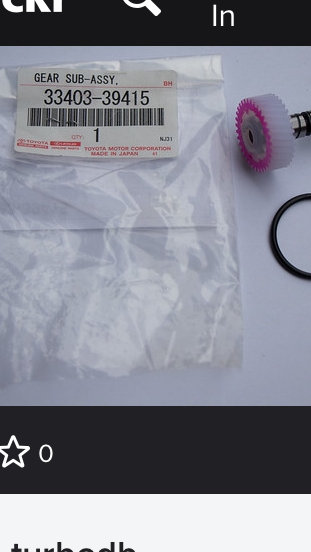

    I have had P265/70r16’s and 235/85r16’s on the stock 4:30 gearing. Now I have 255/85r16’s and 4:88’s.
    Predictably, I got the best MPG bone stock, around 21 city 24 highway. With 235/85r16’s and a growing collection of mods, I was getting a reliable 19 city 22 highway.
    I’m still breaking in my new gears so I don’t have accurate MPG for 33” tires and 4:88’s. But if you want an accurate speedometer/odometer with 33’s and 4:88’s, you need a 33403-39415 speed sensor gear. @turbodb figured that out so thank you! I’ve only got 50 miles on my new gears and tires but so far compared to GPS data, the new speed sensor gear is accurate.
