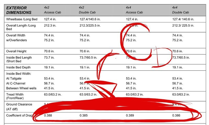

    Does anybody by any chance know what the coefficient of drag is for our tacos?

    42

    You were off by just a little bit
    Turns out access cabs have a higher coefficient. Wasn't expecting that
