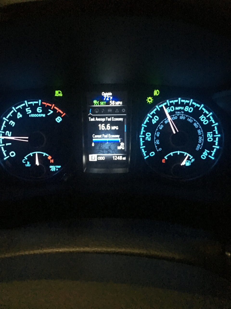

    OP or whoever might want to compare,
    Here is my dash on my normal commute. I’m in 6th. To work stays in 6th. From work kicks down to 5th a lot due to road incline/decline. 16.6 mpg is mileage reset at highway and about 25 miles of pure 55mph. It will start to drop as soon as I get off the highway.
    Again, I have 33” grapplers, 4” RC, cap.
