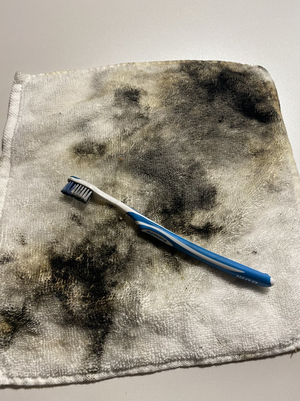

    78501AB2-5B6F-4133-BB9A-F2F5FC52BADE.jpg 78501AB2-5B6F-4133-BB9A-F2F5FC52BADE.jpg
    This is what came off my TB cleaning today. Dealer “cleaned it”
    15K ago
    Less than an hour. 1/2 can of CRC TB spray. ($8) And took care of of MAF while I was at it CRC MAF spray
    Then reset computer 8 minutes idling
    hope it makes a difference

    They could well have cleaned it, but that was then this is now. Definitely a wise idea though
