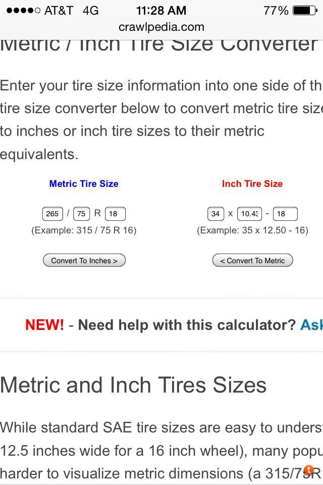

    I just did the metric to inch conversion and you put a substantially larger tire on the truck, your mpgs are gonna drop no matter what. If you didn't want it to change then you shouldn't have put 34 inch tires on it. 9e4ahupu_2028e98444904b16b53facbb72fbc5e56be00b29.jpg
