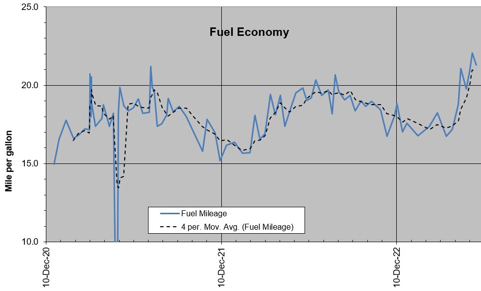

    Only aesthetic mods so far Leer 180 cap & Clazzio covers on order.
    2+ years with my '21 TRD OR AC Auto with a Leer cap (otherwise stock) gives me this:

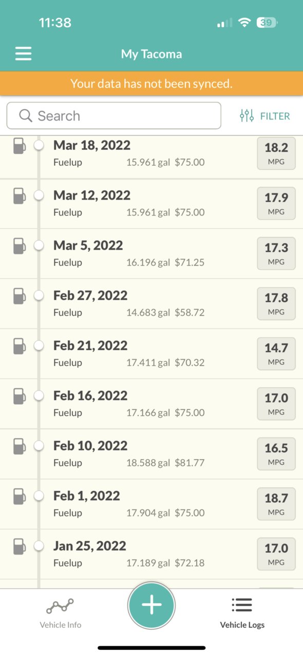

    Front(winch) and rear bumper
    2 1/2” lift
    Sliders
    Engine and transmission skid plates
    33” K02 tires
    Full size spare and recovery gear/tools that I always carry.
    Tonneau cover
    Here’s an example of my MPGs, they would vary depending on the off-roading I did:
    After installing a roof rack and tire carrier my MPGs did drop another~1.5
    I stopped carrying about the mpgs because I got a dedicated daily driver.
