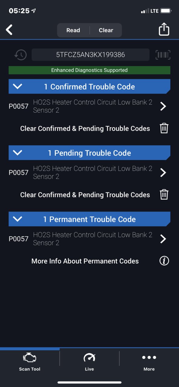

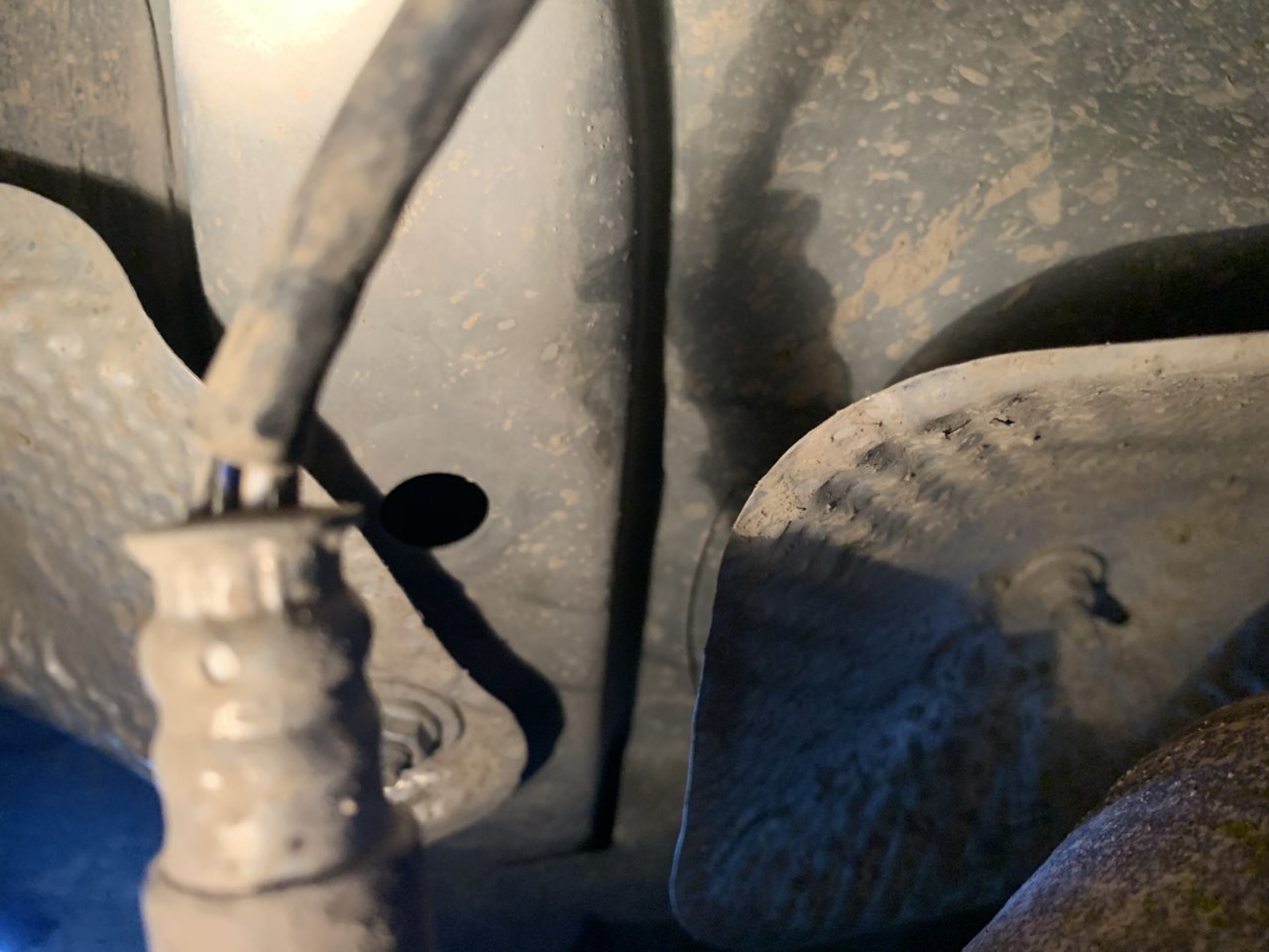

    O2 Sensor Story
    Last Friday when coming down off the mountain, I noticed a clack-clack sound with the front diff engaged. I thought I had a stick in the front propeller shaft. When I got home I discovered the rubber boot at the xfercase end was torn and the clack-clack was the long end of the torn rubber hitting the frame when the shaft spun (why only in 4WD). I have an appt Monday to have the boot replaced.
    Pic of the boot zip-tied up; secured it before I went back to the mtn Monday:
    Yesterday (Fri) when I got ready to leave the mtn for the drive out, Stitch threw a check engine light:
    Used my BlueDriver for the first time; highly recommend this product. Light decoded to:
    Found this, note this is same area as torn boot:
    My local NAPA had the sensor for $62 with military discount ($93 reg price), and I bought an oxygen sensor claw foot wrench for $8 mil discount ($13 reg price):
    Removed sensor:
    Discovered plugs are not identical:
    After this I spent an hour looking for a pin out diagram for what color wire went to which pin location, tried one configuration which was wrong and brought new codes:
    Finally it dawned on me to look at the bank 1 sensor 2 plug and set the pin configuration identical to it. Did so and Stitch is happy again, which makes me happy. :)
    I reinstalled the old sensor and kept the new one on the shelf, as I'm sure I'll need one however many years down the road.
    I'm pretty sure the damage occurred when we sowed the grass seed in the pasture last Thursday (9 days ago). I believe a root speared that area as I was crawling around the pasture in 4Lo tractor mode while Danny sat on the tailgate with the seed thrower. I left the pasture in 2Hi, and didn't use 4WD until Friday morning, when I noticed the clack-clack. I have no idea why the code didn't show until 8 days later, other than I reckon it took that long for the pins to work completely loose and break contact. :notsure:
    But now I know a little bit about O2 sensors. :cool:
