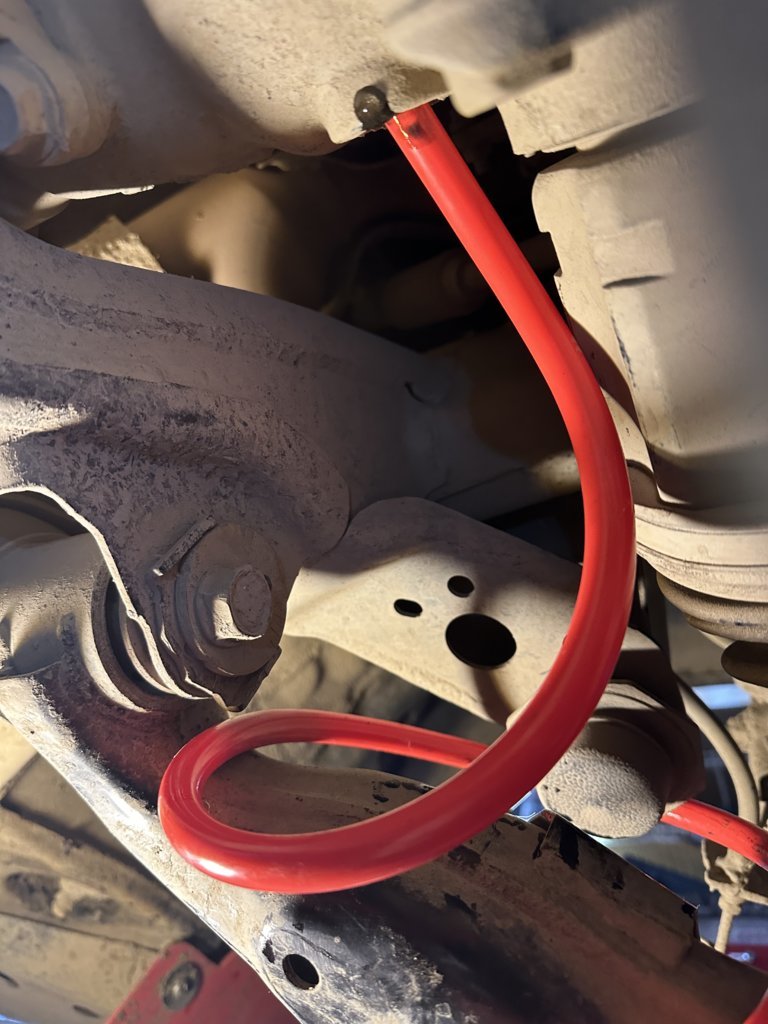

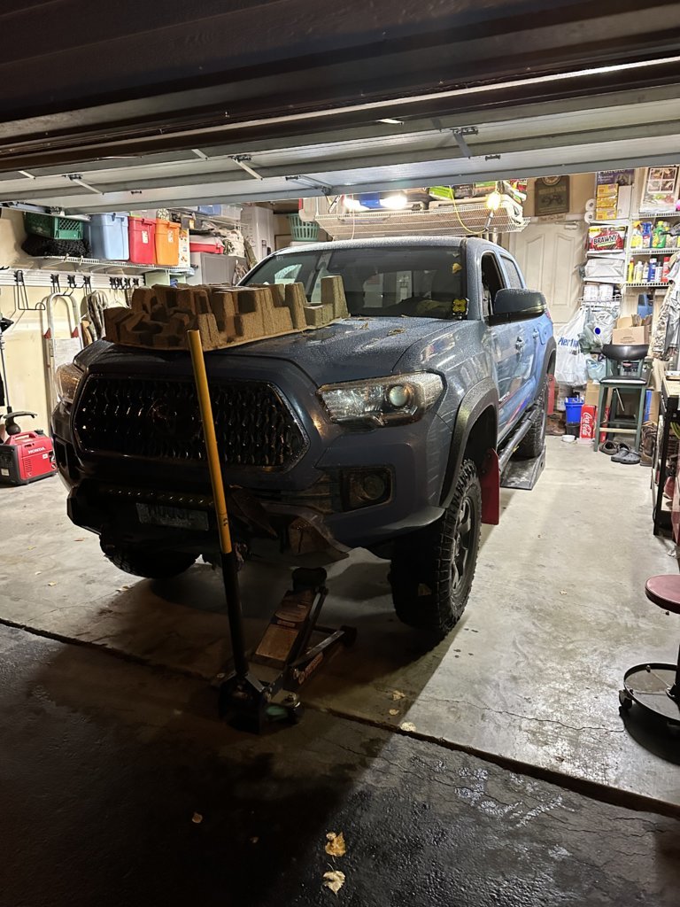

    Up and close enough to level. Even remembered to loosen front lugs before jacking ... to facilitate tire rotation.

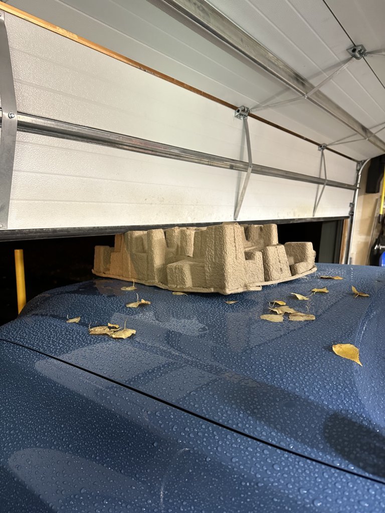

    If anyone was wondering about cardboard packing ... this
    Garage heat on to knock off chill ... not terribly efficient, but helps. :laugh:

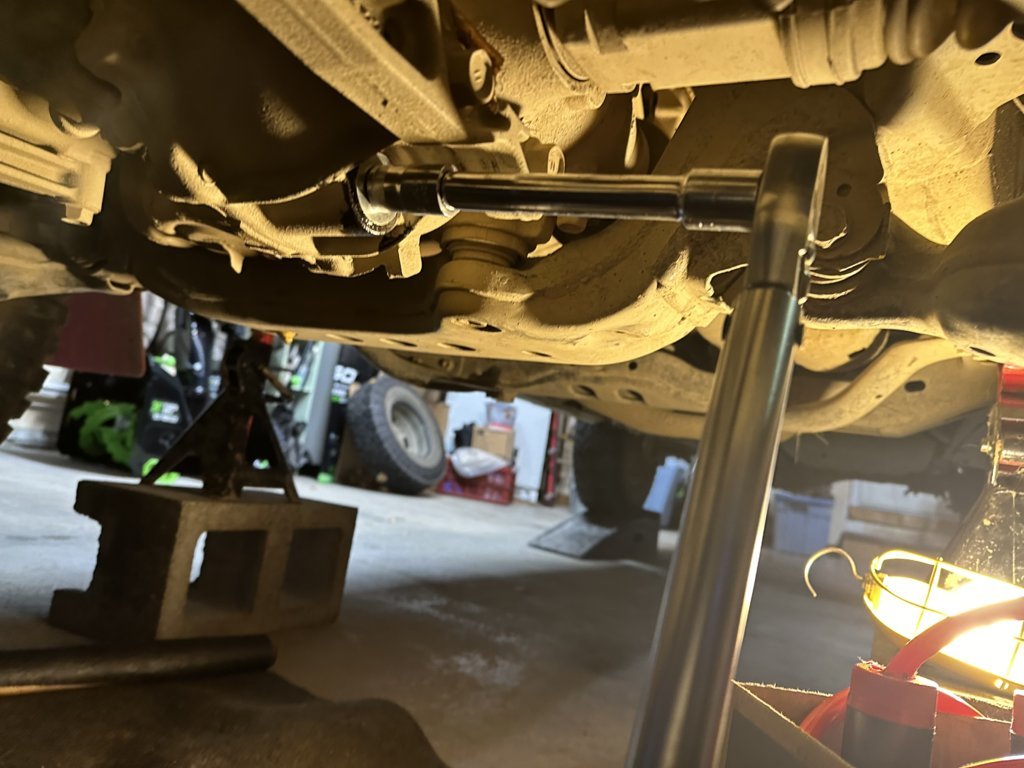

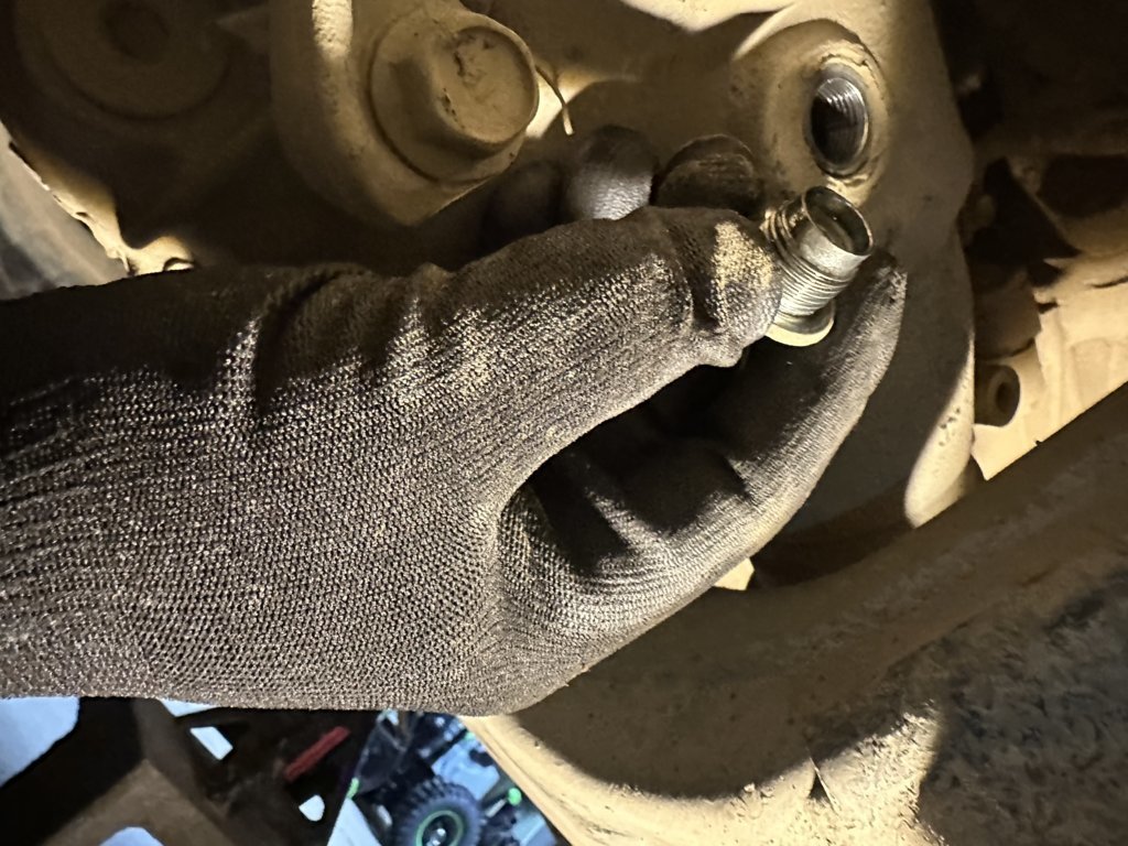

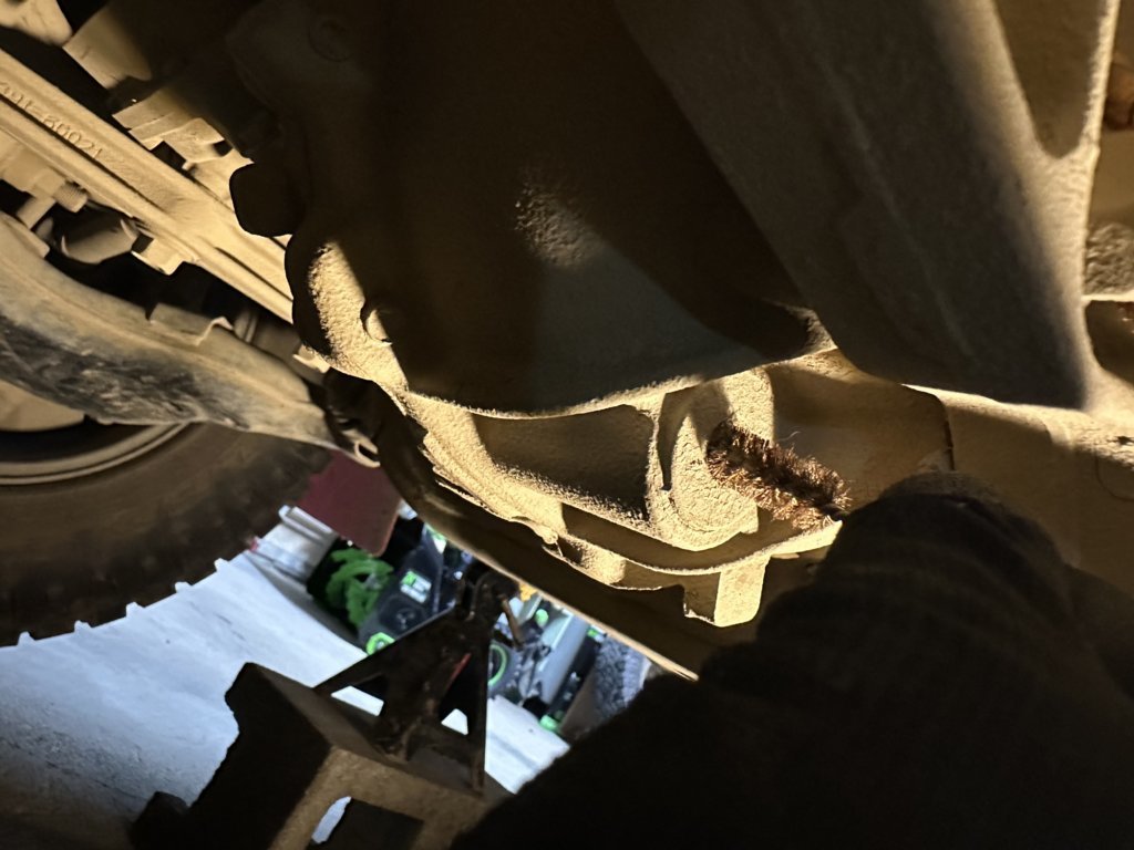

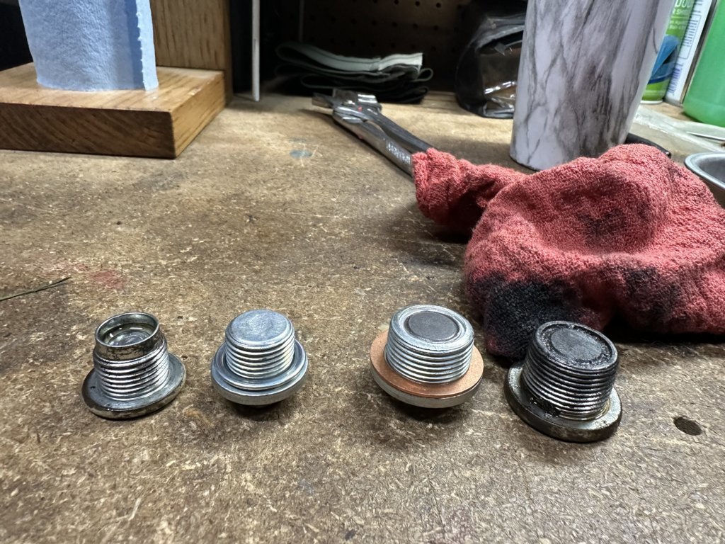

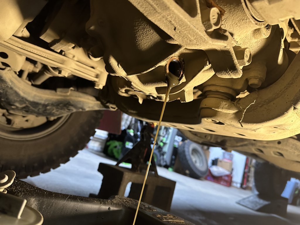

    Plugs out and draining.
    MooseMan Tip: 22 caliber bore brush works well cleaning out the 10mm hexhead so the socket gets a good bite.
    I'll reiterate, and don't often say this but, F@CK You Toyota for using the damn hexhead plugs!
    Got 'em out and GLAD I'm replacing with the 14mm boltheads.
    This fluid was very dirty and drain magnet had heavy sludge ... I use 4WD a lot.

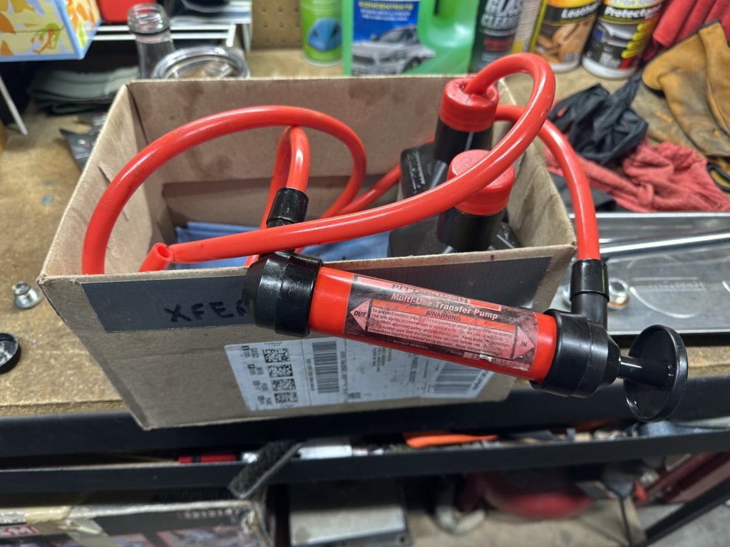

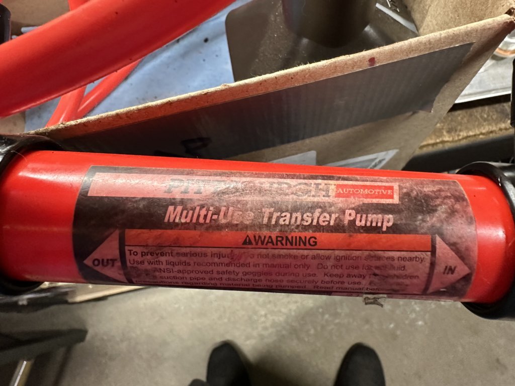

    Oh ... @AllTacosFloat , asked about transfer pump last week. Picked this Pittsburgh kit up from Harbor Freight probably 7 or so years ago on a PHX visit. I like it better than the bottle pump and it works well for my frequency of use.

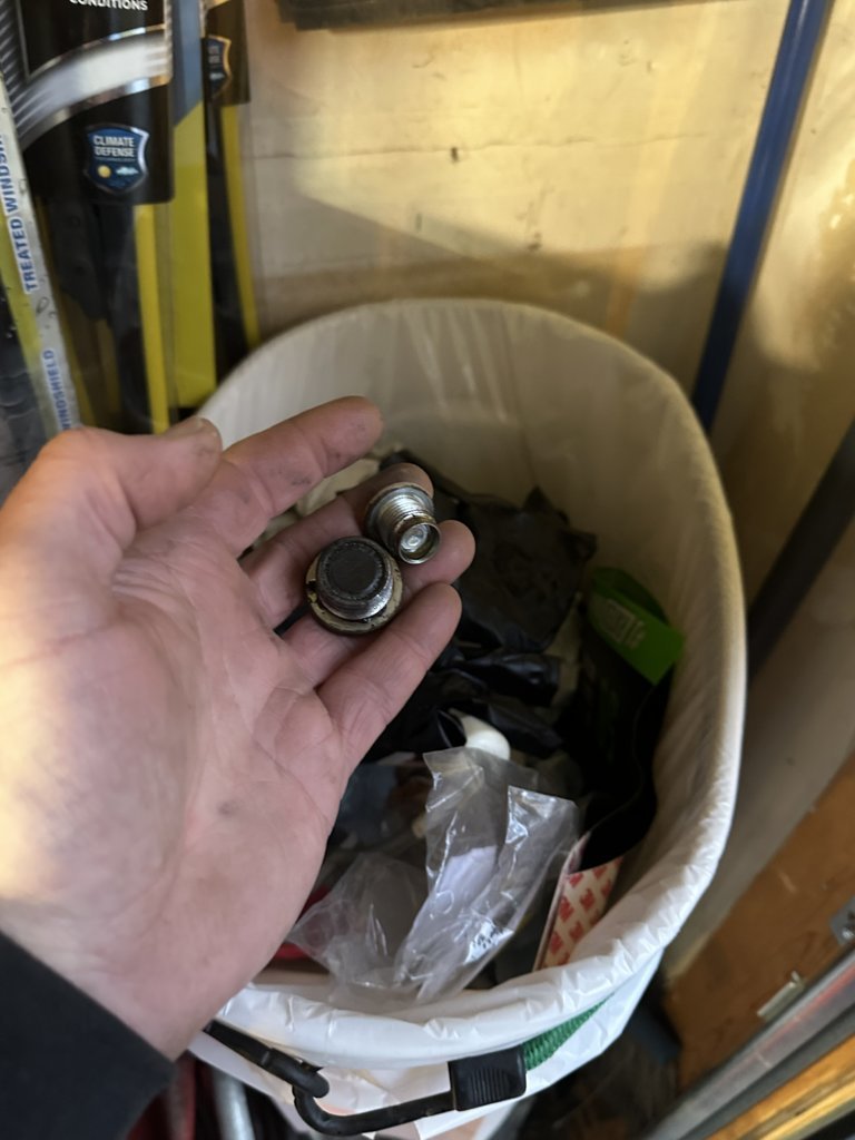

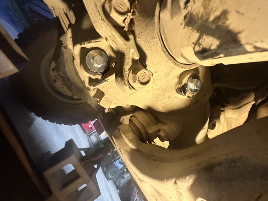

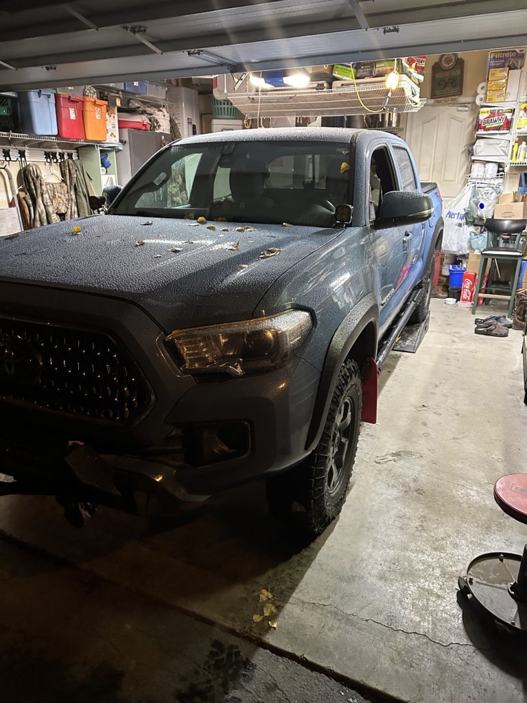

    Front Diff Done
    Bye Bye Hexheads :brianr:
