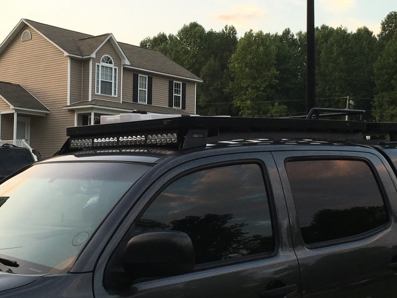

    A little glimpse into today's activities

    That's rack and light combo looks sweet. Subd for pics

    A couple of rear window decals...
    What'd you do with the rack/lightbar, and what'd you use to fill the gap between the two? How difficult was it to remove/replace the rack?

    What do you "what did I do with the rack/lightbar"?
    I used a rubber bulb seal that I pressed up into the grove of the rack and the seal has a lip to it that sticks down. That is what you see between the rack and the light bar. Make it so much quieter.
    The rack is easy to get on and off. Having a friend helps a lot, b/c it's a little heavy. Definitely when you get the light on there. I had to cut some of the front mounting point for the rack so the light bar and rack would fit in its proper place.
