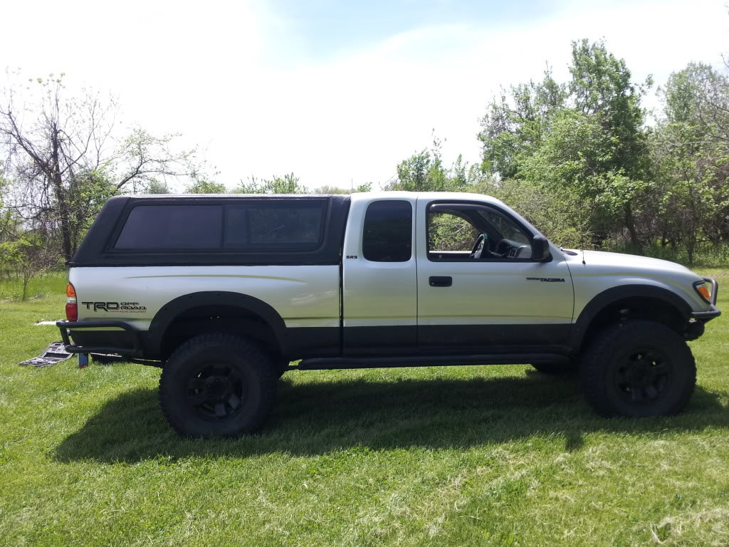

    I already did my rockers awhile back :anonymous: most recent picture I have of my truck from the side. The cap isn't on anymore.

    ^^nice!! Looks clean

    What brand of bed liner did you use for your rockers?

    It's the dupli color coating in the 1gallon can. It's a 3 part mixer. Rubber, color, and hardener. I've had it no there 2 years now. Holding up great!

    Nice! I've heard good things about the duplicolor stuff. The stuff I've seen in person looked pretty good. I used herculiner roll on bedliner and put a coat of rustoleum over it a couple years after I did it. Helped fill in the little spots where the bedliner was a little thin and the silver paint could be seen through.
