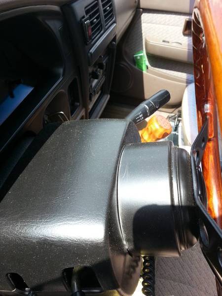

    Haha thanks man! Those shift knobs turned out great!!
    I see you didn't use an extended hub or anything? Do your hands not hit the wiper control and signal lights when you turn?

    Thx, I'm pretty happy with how the knobs turned out. There is actually a 3" spacer for the wheel which i covered with a 3"-4"PVC coupler. i had to turn the inside just a bit to get it to slide over the spacer. it fits very snug and spins with the wheel. Then I plasti-diped the whole assembly. The diameter of the coupler blends a little better with the blunt edge of the column cover IMO.

    Nice. You did a good job. My hub doesn't quiet cover the entire cutout of the trim either. It doesn't really bother me though haha
