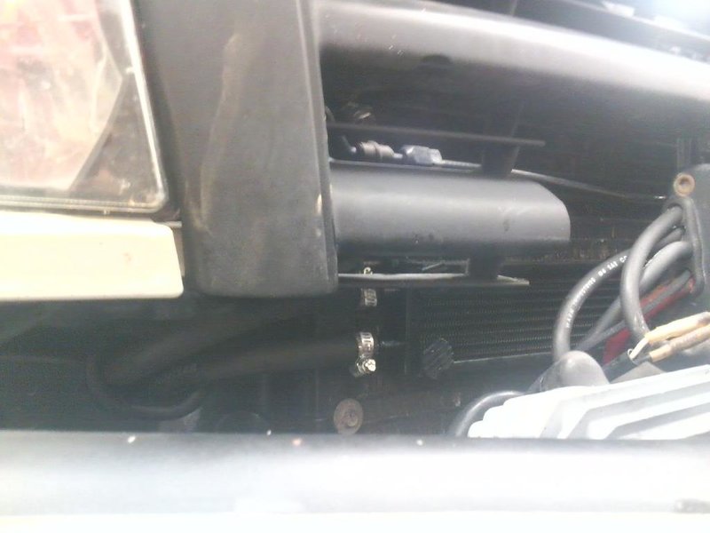

    just curious, what r guys looking to gain from an upgraded pump when still running ifs with a steering rack?
    i grenaded my pump last year in the sand dunes in moab. granted it was original and i was being super mean to it....
    i replaced it with an oem pump and installed a p/s cooler. cut my return line and made some new soft lines and ran them to a cooler mounted in front of the condenser. this seems to be working awesome because 1 it obviously cools the fluid but 2, the system now holds alot more fluid.... fluid capacity helps with longevity of the pump and rack. check it out, was cheap and not too difficult to do.... more pics in my build
