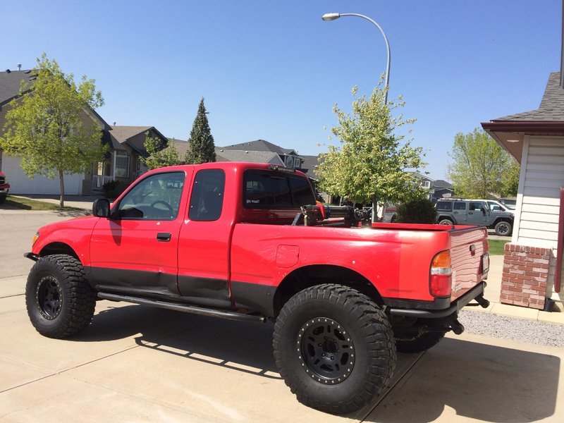

    Not much is new! Bobbed the box another 3" and cut 3 more inches out of the frame. Shackles stick past the tailgate now. New wheels maybe?

    One off questions, how did that trim hold up on your fenders? I recall a post way back where you put some trim over the cut marks. Worth it?

    That trim fell off on the first wheeling trip haha. I've since then just masked off a 1/4" line all the way around and sprayed it with box liner to keep it from rusting

    Another fender question here. I was tempted to cut the fenders all the way up like @thegame did but I realized that to go high enough to get rid of the holes, I'd need to cut into the gas tank door too which I really don't wanna do. You just painted clips to fill the holes right? Are you still happy with that? I know I want glass up front to clean it up but that won't be fore a while.

    Yea they work. If one pops out cut down a new one and jam it in
