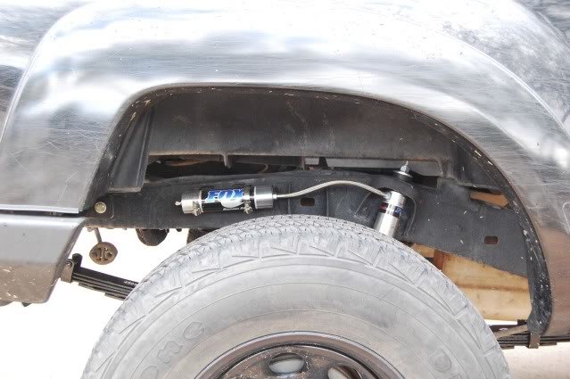

    do you know what valving you got on these? do they have a system like bilsteins?
  11. Jan 23, 2012 at 7:59 PM
    #131
    mreimann
    mreimann [OP] Well-Known Member
    Aug 19, 2009
    #21434
    2,513
    Denver, CO
    '15 double cab Limited
    Icon C/O, Fox 2.0, All Pro Expo 2.0 leafs, Total Chaos UCA's, Airflow snorkel, Custom Built Bed Rack, Pelfrey aluminum front bumper and IFS skid, All Pro aluminum rear bumper, SmittyBuilt winch. RTT
    These have stem tops and bolt right in. The lower eye was a little wide and I had to either grind it down a little, or pry the shock mount on the axle open more. Not sure if it was just my truck, or a design thing.
    not sure on the valving. I wanna say 60/40 or 40/60. I know they are slightly stiffer than how they come from the factory. However, with my expedition leaf pack they are a little too stiff. If you have a standard pack they would probably be perfect.
    What system are you talking about?

    Do the dakars increase the weight capacity? I'm almost certain they're softer than the expos.
    Not sure on the valving. Post up in the LT BS thread, they probably know.
