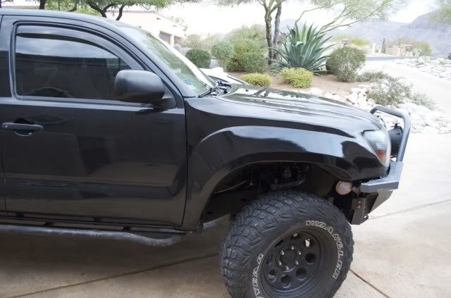

    Thanks matt. I've been with family all day and haven't had the chance to take better ones
    The finish turned out much better than expected (because I've never used automotive paint before).
    Slight orange peel finish in some areas, and a lot of dust got caught in the clear coat. But once the paint hardens enough I'll put them back on the truck and wet sand/polish that stuff out.

    Texture of the clear coat before wet sanding

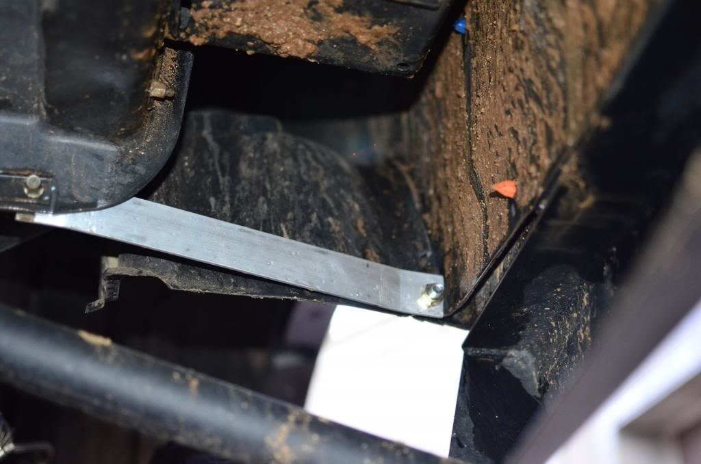

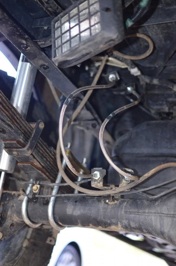

    U-bolt flip and extended brake lines
    Aluminum braket to support bedsides

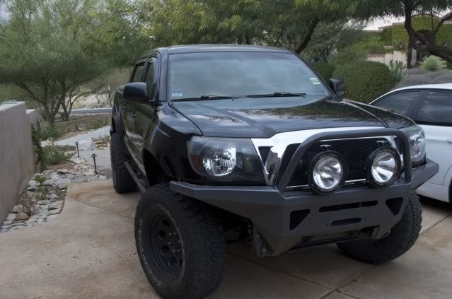

    Fenders mounted back up

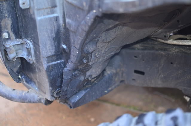

    cab mount chop/hammed back pinch weld

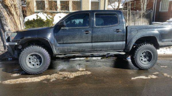

    About time for an update

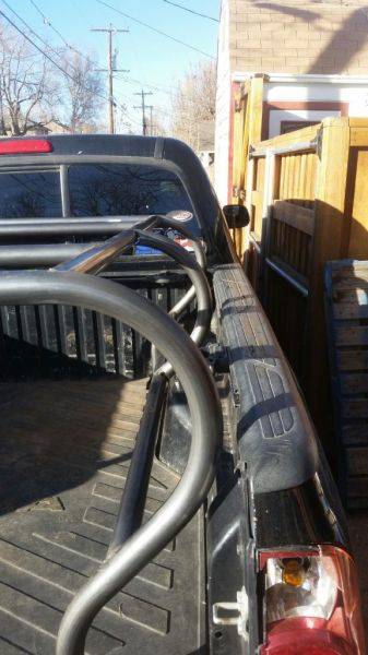

    Got a tubing bender so I could build a new bed rack for the RTT which I got direct from the manufacturer in a group buy of sorts.
    Also got some new wheels and tires. American Racing Mojave with 255/85/16 Cooper Discoverer ST Maxx tires. Definitely better than my last set up. My main motivation for the switch was to get a better fitting wheel and softer/lighter tires. I've been burning through wheel bearings, so I figured stiff suspension plus heavy and poorly fitting wheels might be causing it.
    I also have longer coil springs sitting in my dinning room that will be swapped onto my front shocks tomorrow to help reduce some of the pre-load.

    @05tacomabro This is the build finally found it.. That's the bed rack i wanted when he got it!

    Might as well give you a better picture of it
