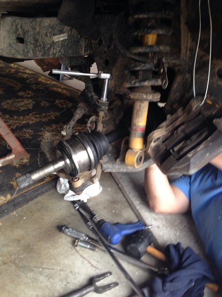

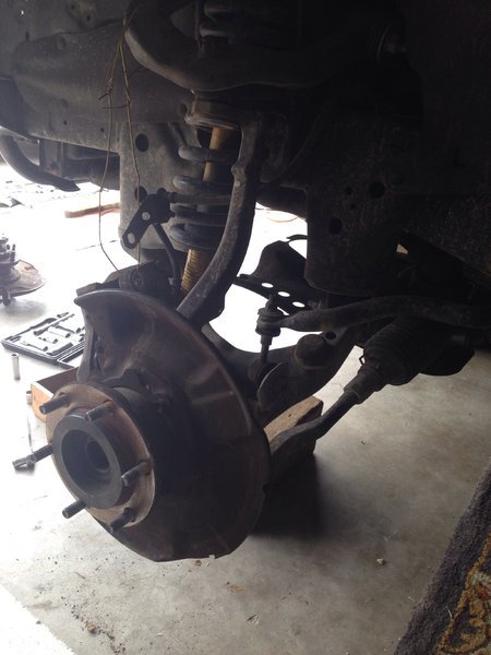

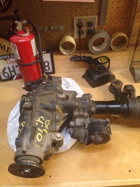

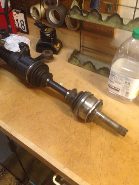

    Update: First half of 4WD conversion beginning to take shape! Got almost all of the front end parts, just need one more axle and new ball joints.
    Jebediah likes this.

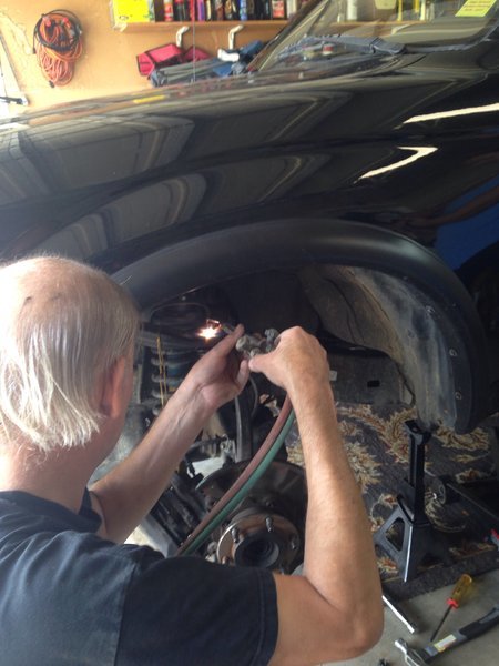

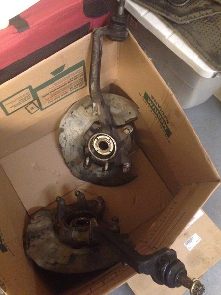

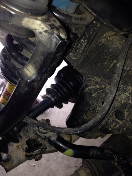

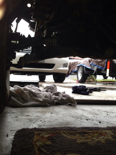

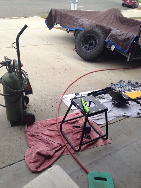

    Front end part install pretty much complete. Unexpected delays with driver side ball joint removal, lower bolts for steering linkage on spindle were in really tight, almost seized and broke 3 of my 14mm sockets, took a pneumatic air ratchet to get them out, upper ball joint stud wouldn't budge from UCA, had to get a big ass blowtorch and heat it up nice and hot, and still had to use an air powered hammer to get it out. One side of the truck took a whole day to do, the passenger side only took about and hour.

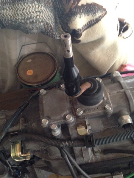

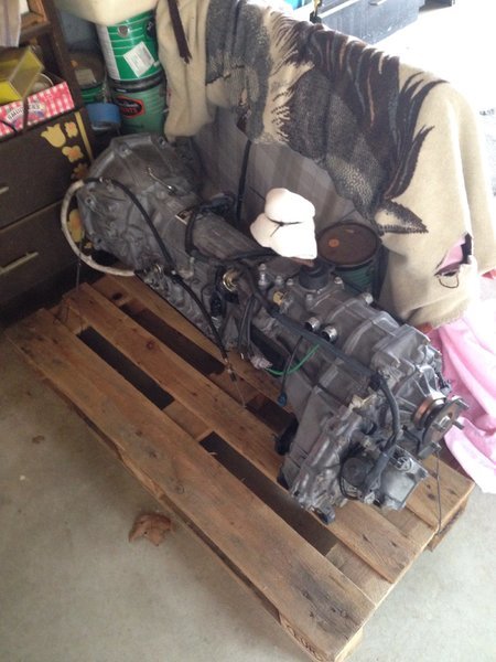

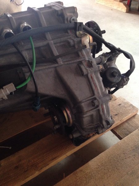

    Just picked up this baby today
    A340F off a 4Runner. Got it from a place in Santa fe springs called jdm west coast, great group of guys. Only has 50k-60k on it and only cost $650 after tax.

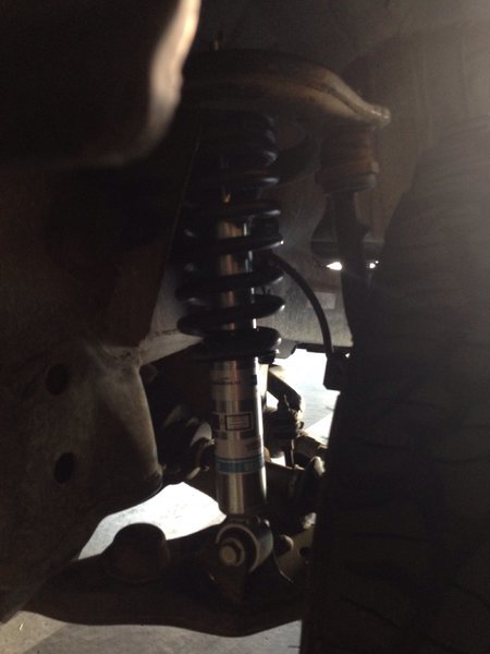

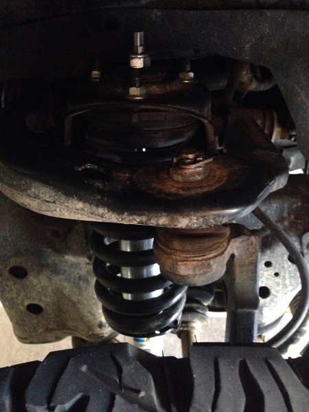

    5100's in! The rear ones were so old I could
    Fully compress them using just my arms with little effort
