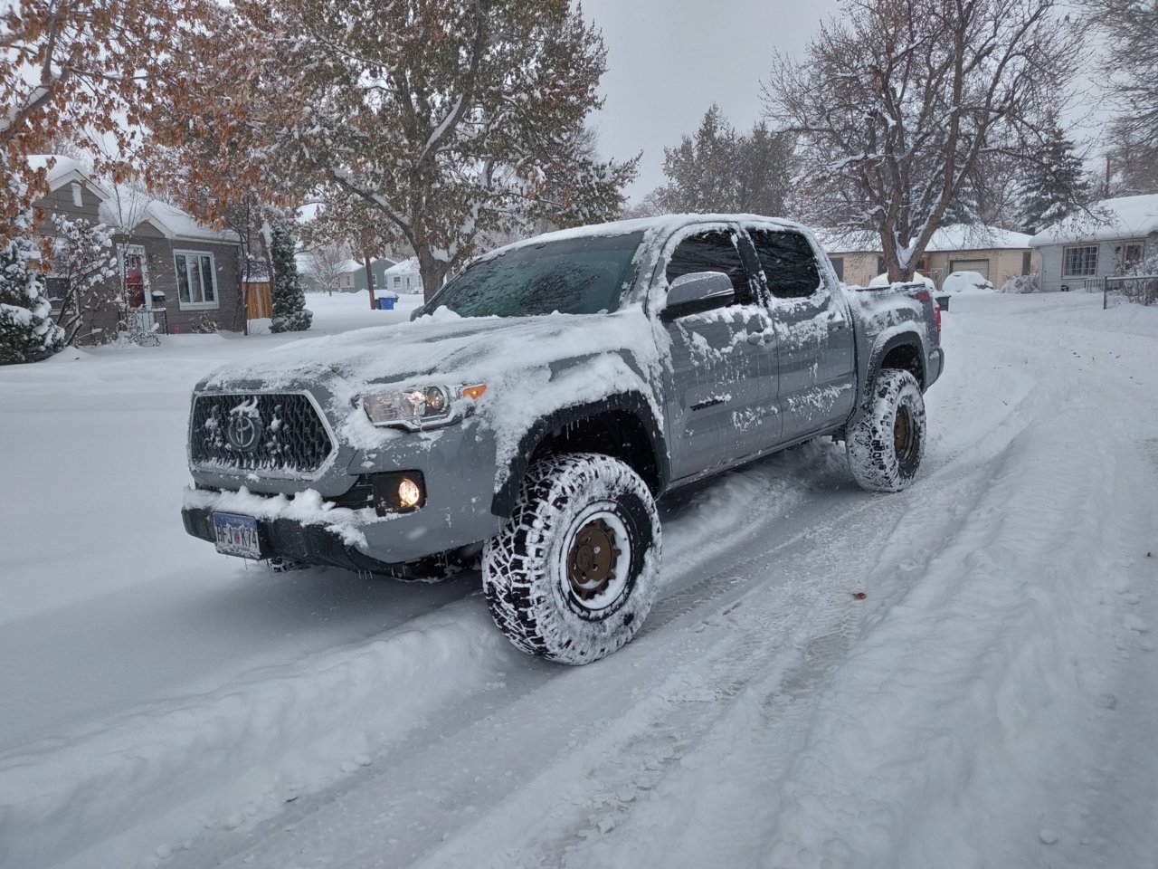

    Unfortunately not from yesterday but this was from an 18" storm last November. Man I had a blast romping down unplowed roads to go to breakfast that morning. Also had to pull out my buddy's Frontier that day.

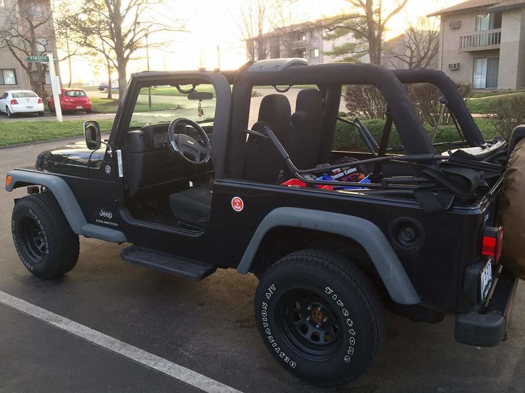

    I'll have to get a good updated picture of it but this is right when I put the gladiator takeoffs on. It's got a matching spare now. Forgive me everyone for going a bit off topic.

    Yeah.... Good stuff.
    Uh, and no accumulator, as a point of topical reference :D

    My man! Oh yeah... Also has no accumulator:drunk:
