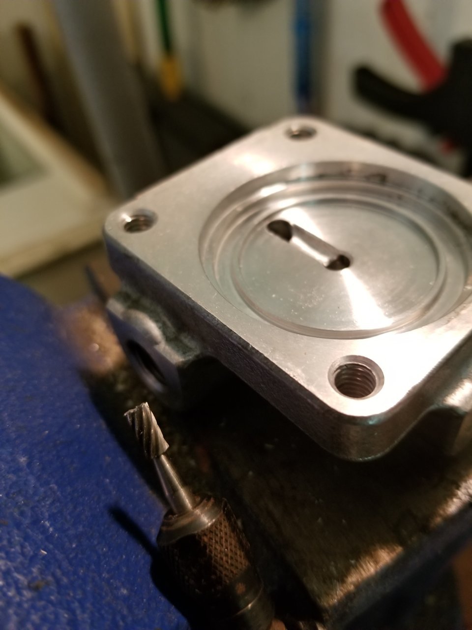

    Just grind the accumulator. Free and easy.

    A round burr would be easiest, but you could probably accomplish it with a sanding drum. The little grinding stones don't usually work well on aluminum, they get clogged up pretty quickly.
