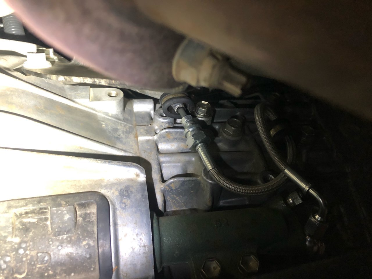

    So I just did this mod with the flexible line and banjo. I can't seem to mount the banjo bolt at a angle that will allow for the heat shield. if I leave off the heat shield will I die?

    I've no bloody heat shield for approaching 2 years and ZERO related issues.

    I know a guy who left his heat shield off back in December of 2019... Look what happened to the world since

    Only way I could get this stupid thing on here. The loop seems like a bad idea but the bend at the banjo made it weird.

    I want to say thank you to all those that have done this and shared their difficulties and successes.
    I used the premade line and coupling that are available at most auto parts stores.
    I read through all of the posts here and followed the tips about being very carful when threading the line attachments, and allowing a drip bleed once the top attachment was made to fill the new line.
    One thing that worked for me was partially threading the slave cylinder nut in, but not tight, then attaching the coupler and letting the fluid drip and leak at the slave for a while before tightening it. This made it easy to get the lower fitting lined up and treaded to get a solid seal. I probably dripped about half the reservoir through before tightening it. When I then did the 'pump and release' bleed at the slave cylinder, I got maybe two or three air bubbles and then it was good... Could not have asked for it to go any better.
    If you haven't done this mod yet, I highly recommend it. The clutch does feel more like it should and it reduces the clunk you get sometimes when shifting quickly.
