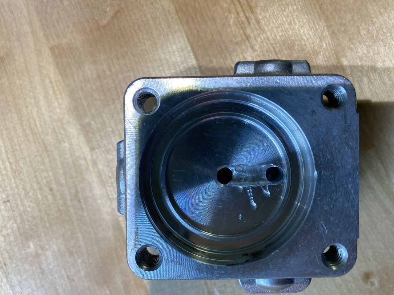

    Just did this last night, went with the dremel mod. Initial impressions are good.
    Quick question, when doing the bleed process, does the clutch pedal come up on its own when all the air is out or do I have to pull it up by hand no matter what as long as no air bubbles are present anymore??
  19. Feb 11, 2021 at 7:43 AM
    #2179
    tonered
    tonered [OP] bartheloni
    Sep 25, 2017
    #231055
    31,329
    tony
    Lynnwood, WA
    Excellent.
    Yes. Once you close the nipple, you have to pull the pedal up off the floor. It will take a couple pumps of the pedal for the full pressure to return.
    The clutch engagement point should be at the same spot when you are done.
    CygnusX191 likes this.
