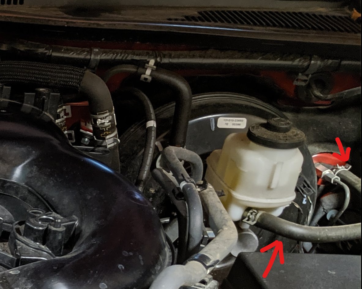

    There is a separate one on the ORs and Pros. The Sports and 2016 / 2017 SR 5MTs draw from the main brake reservoir. This can sorta be seen here:

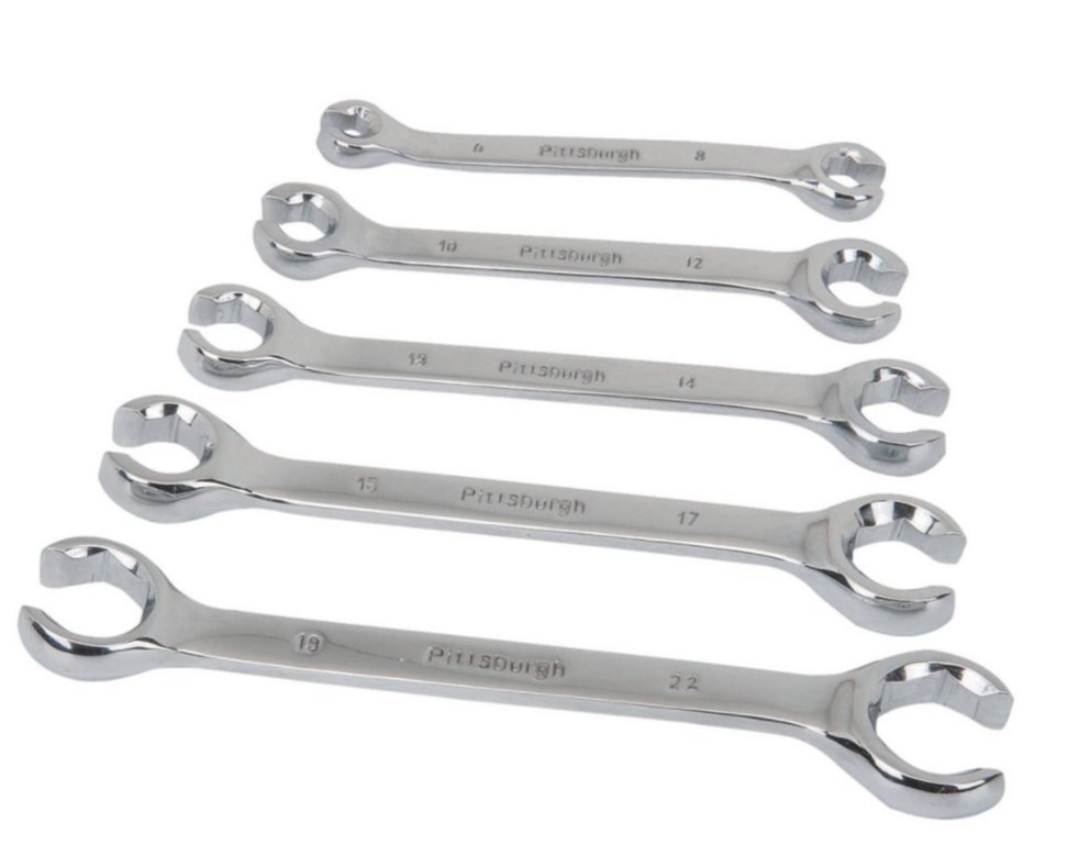

    whats the difference between a flare nut wrench and just and open end wrench?

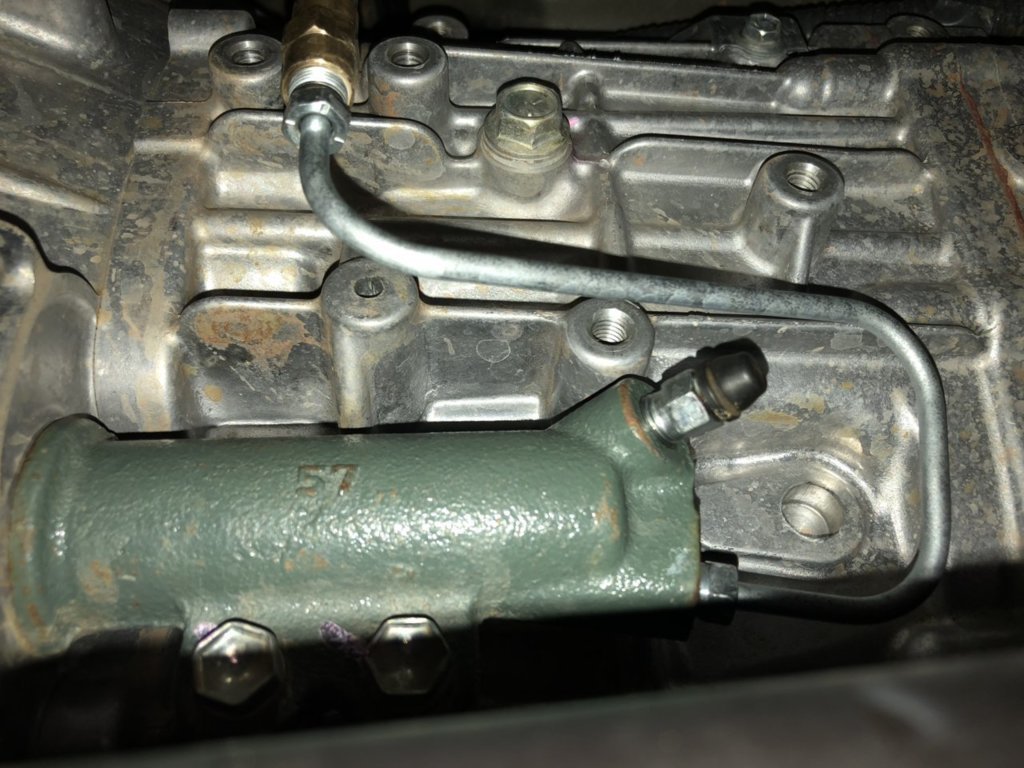

    Where do you crack the line to let the air out? like with brakes you crack the nipple at the caliper

    There's a bleeder on the slave cylinder IIRC
    There it is!

    A flare wrench grabs on four or five flats versus two or three. Flair fittings are weaker than solid fasteners and can round or crush easily. The 11mm is a bit thicker and stands up to an open ended wrench.
    The bleed nipple is on the slave. You can see it in pics in the 1st Post. upload_2021-5-13_7-17-54.jpg

    so bleeding would be the same process as bleeding brakes? would it be worth it to get an 11mm flarenut wrench to be safe?

    If you can find one. It is an odd size and was an unexpected surprise when I encountered it.
