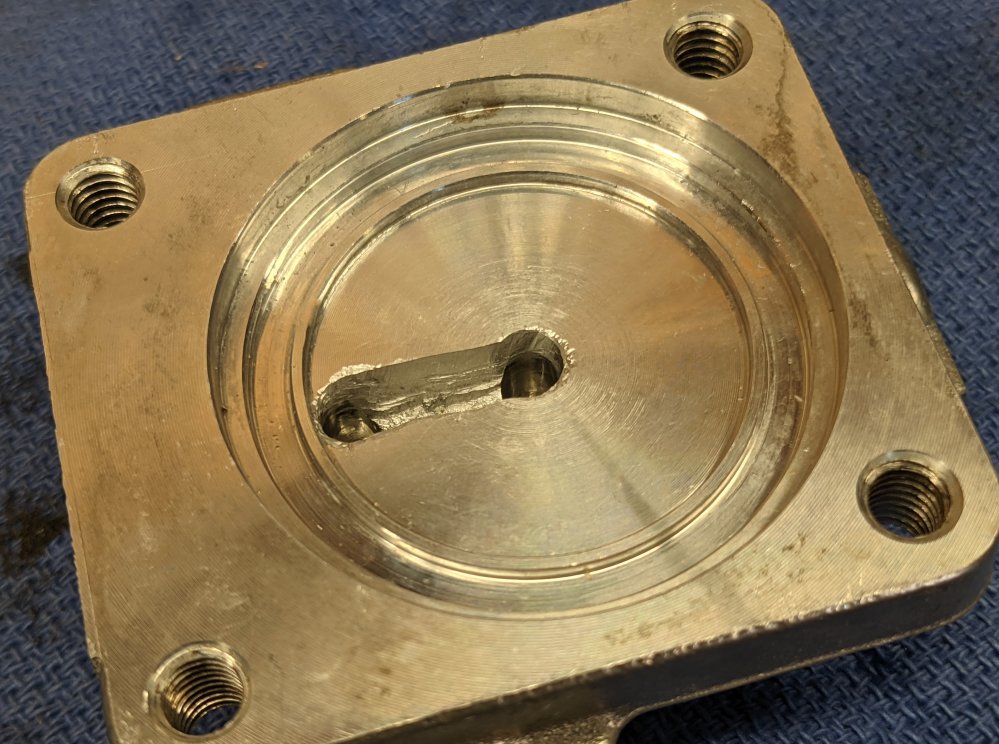

    Okay, so I did the Accumulator "Defeat" mod today - didn't delete it.
    So, I was really unsure about doing this mod, but due to construction, I've had to take a new route out of the neighborhood, one that required quite a few uphill starts. I've been driving manuals since 1991 and I've never had so many problems with uphill starts, so I decided to give this a try.
    First, the difference is not HUGE or Monumental, or anything like that. But the clutch does feel more "normal"
    Maybe, I'm less excited because I don't fully trust my bleed job because the clutch movement is also a whole lot lighter.
    However, the friction zone is about 1/3rd of the way off the floor (it was at 8/9ths off the floor before), and it stays there. It doesn't move around in different situations, so uphill starts are absolutely way more consistent, and even just normal day-to-day shifts are easier to get perfectly smooth.
    So, was it worth the two-hour investment? If you deal with uphill starts, absolutely. If you have nothing better to do. Sure, why not. But I don't think it's as dramatic of an improvement as it's implied to be. I think if you are experienced with a clutch, you know how to be adaptable, so the accumulator, while a stupid unnecessary widget, wasn't that intrusive.

    Yeah. You got more bleeding to do. Weight and engagement point should be the same.
    Some, like @TeecoTaco , will say that the air may bleed out under normal driving.
    I do wish the engage point was more toward the middle of the travel, but we don't have a setup that allows that adjustment. I bet a 1mm smaller M/C would do that.
    In the end, natural feel is what it is all about. The accumulator did not give me that, so I am thankful for the mod.

    Okay, I need to amend my previous opinion. After a week of driving with the Accumulator Defeat, It is absolutely better in every way, and completely worth the two hour investment. Shifting is way more precise, uphill starts are much easier, and downshifts on a steep uphill are way easier to do smoothly. Bonus, when I hop into my wife's car (also an MT) I no longer struggle adapting to how hers shifts because both cars basically behave the same way now.
