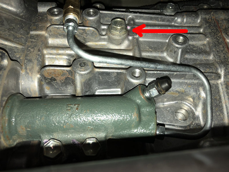

  15. Jun 23, 2021 at 7:23 PM
    #2315
    manncura
    manncura Well-Known Member
    Aug 25, 2020
    #338785
    346
    2020 DCSB 6MT Sport
    Lets just say some guy who can sometimes be a little dense, was attempting the ADM ,,,and while attempting to remove accumulator body, removed the bolt shown in the image attached instead of that top right mounting bolt on the accumulator. Bolt was returned to its home immediately and tighten snug. Anyone know how this person could find the torque spec for that bolt (it broke free pretty easy) and if the removal would cause any issues? Thanks!

  17. Jun 23, 2021 at 7:40 PM
    #2317
    tonered
    tonered [OP] bartheloni
    Sep 25, 2017
    #231055
    31,330
    tony
    Lynnwood, WA
    I had to go back and look at pics as I didn't even realize that it was there. IMHO, I'd grab the shared Service Manual and see what the hell that does. The torque spec will be next to it.
    Actually, go here:
    http://www.ttguide.net/toyota_tacoma_2015_2018_service_manual-171.html
    Soooooo, that's why you still have that bastard installed. :D
    CygnusX191, C41n and Inferno__Taco like this.
  18. Jun 23, 2021 at 7:43 PM
    #2318
    mZiggy
    mZiggy Honey badger
    Apr 8, 2017
    #215707
    4,709
    Marc
    2020 MGM Tundra SR5; 2020 4R TRD Pro; 2008 4R SR5 v8
    It's stripped. Has that "permanently installed modification" lol
    CygnusX191, C41n and Shellshock like this.
