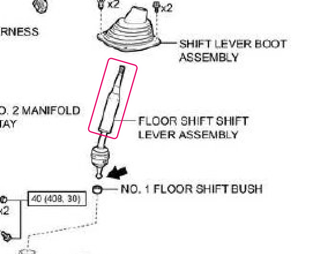

    Does anyone know if its possible to change the shift lever? Only the lever, not the entire "floor shift lever assembly."
    If it were threaded on and could be swapped out that would be great. But I'm not about to just go torque on it to find out. Best I've found is videos removing/replacing the assembly, but no good pics or info on the lever or how its attached.

    I'm pretty sure cut and weld is your only option, and likely not a good idea. I believe everything below the rubber isolator is one piece. You may be able to somehow separate the upper and lower pieces, but you would then still have to add a sleeve, threads, or some other way to attach an extension.

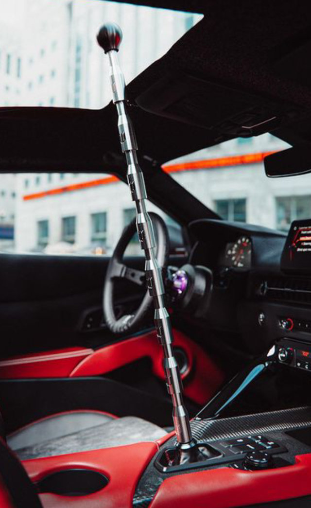

    You could put a core short shifter in there
    JDSmith, poopshute and CygnusX191 like this.
  14. Jul 5, 2021 at 9:22 AM
    #2414
    philth
    philth .
    Oct 31, 2020
    #345418
    1,154
    Why stop at just one?
