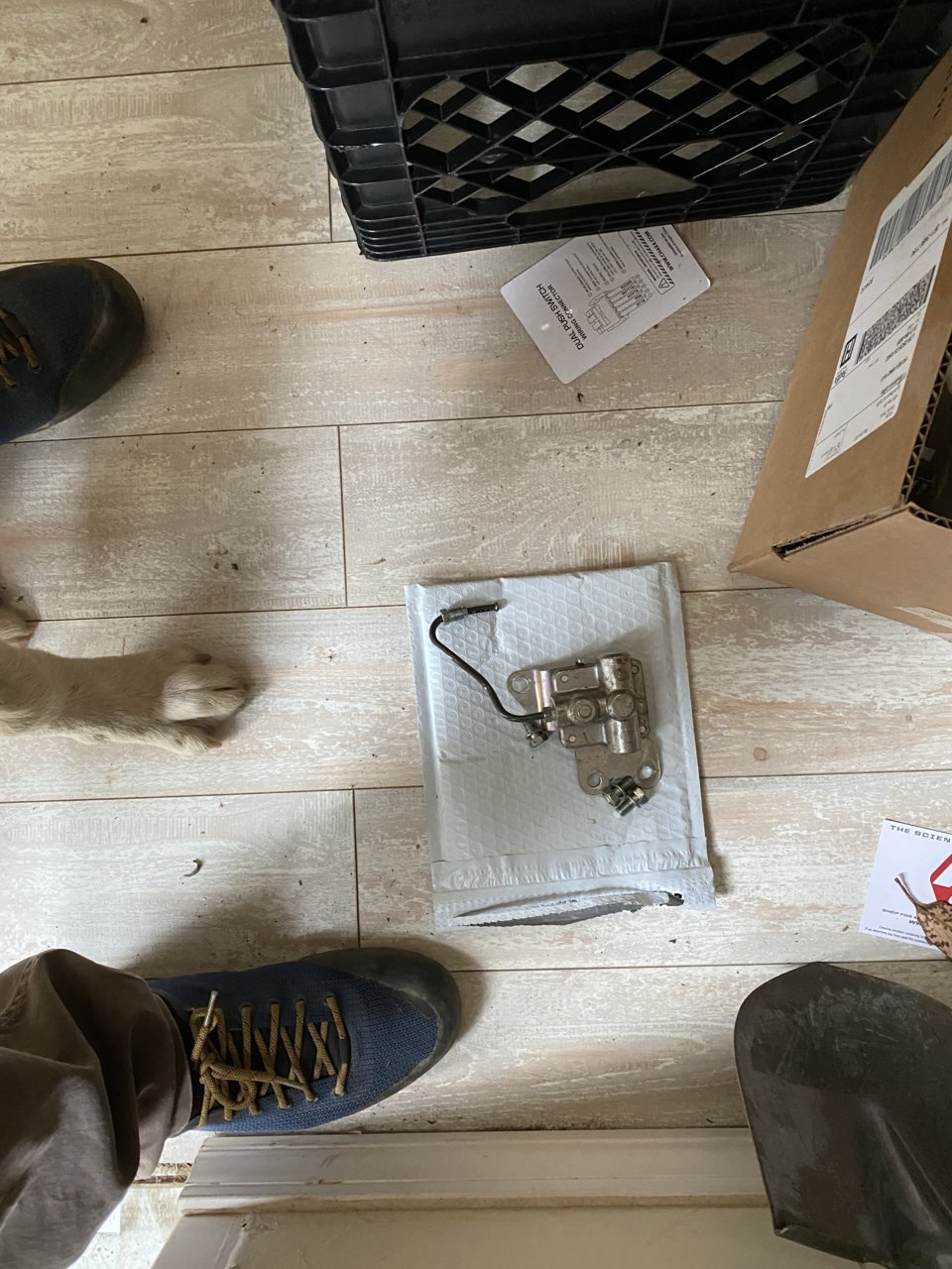

    Some stuff
    3CC75DE0-1D64-4B7E-80AE-271A90EB99D6.jpg Add another to the pile. I used the Honda line. I have to say I didn’t want to do this mod… I guess I’m was worried about fucking it up. So, I actually did it because I added in an aux fuse tray, and had to shorten the reservoir hose, so I’m using the excuse to drain a little fluid. But holy shit, the difference. I have a dirt portion on our driveway, it chirped on the way up, unreal change of power. But, I think I still have a little bubble in the line, my clutch feels real “funny”
