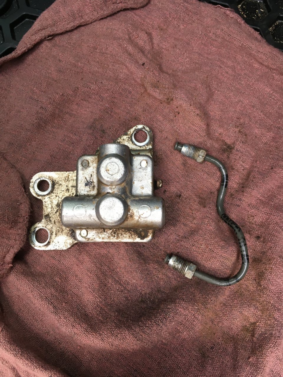

    Bye bye stupid thing.
    Shifting much, much improved.

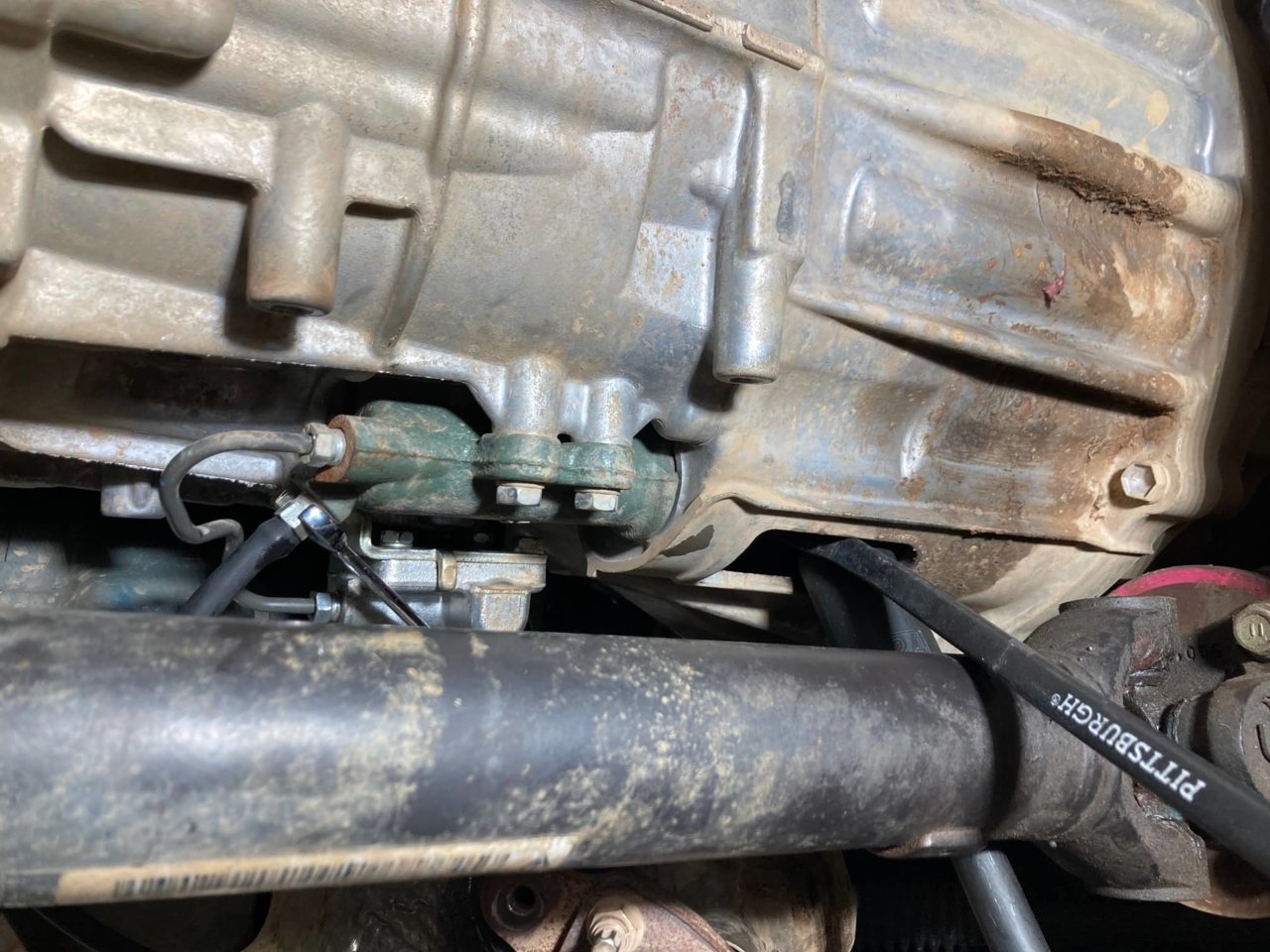

    Y'all must be geniuses to pull this off in 1–2 hours. Overall, Dremel hack ADM took me over 5 hours, most of which was spent bleeding the clutch solo. Lurching greatly diminished, solid feel, and much better drivability!
    Anyhow, since no one else mentioned it, an easier way to compress the plunger:
    • 24mm impact socket
    • 10" socket extension
    • Pry bar
    Attach socket to extension, insert into housing cavity.
    Use socket as fulcrum for pry bar to compress the cylinder.
