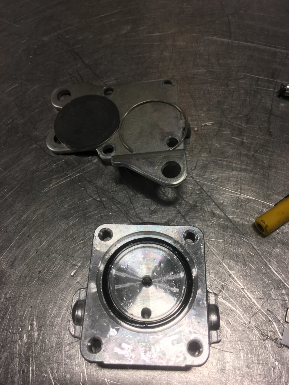

    Ok I think we may be overthinking this.
    I can shine a light into both holes where the lines go in/out and see no restriction. On top of that my accumulator does not have a plug in the casting. Therefore there is not a internal restriction, check ball spring or anything else I can see.
    IMO it is a over engineered simple restriction. The two holes inside the black o ring are covered by the metal disc and this is restricting the flow.
    There is a possibility the disc can move some away from the holes but I’m not positive on that.
    My point is, one could say use a dremel and join the two holes with a shallow path and remove the restriction. Put it all back together no parts needed other than brake fluid.

    I am not sure about that. I did not cut mine up since I wanted Rick to see the whole part, but I am guessing that the inner disk is either swaged / pressed into place or it is a freeze plug? The delayed pulses that I could feel in the clutch esp when modulating it on downshifts felt like a restriction combined with a ball / spring since it was not a constant rate? I could be wrong, but the shape of the other side also has me guessing that there is more to it.
    If it was just a restriction, other MFGs use something like a venturi to reduce the diameter of the line to reduce flow.

    That is what I am saying. I couldn't see a joint on the side that you are talking about, but some swaged joints are that good. Like I said, I could be wrong, but I believe there is more to it than meets the eye?
    Maybe @7r41lbr34k3r can post up some thoughts or pics if he cut mine up?

    Didn't cut it up, but unless I am missing some parts I really wonder how this thing doesn't leak.
    There is a split ring in there that seems to act only as a spacer. Then you have the gasket just floating in there, and I'm assuming under pressure it just seals up?
    But yeah, just drilling it out to connect the ports should work. Fluid would still go into the disc, but it would just equalize and take the path of least resistance.
    I fear that custom tool I need to email about is going to cost too much for this to make sense (making from scratch). I could make a custom trepan tool and do it on a lathe in a 4 jaw chuck, but I don't feel comfortable doing that as I haven't seen any tolerances or specs for the fitting online.
    TD90S and tonered[QUOTED][OP] like this.

    Yes! I had the same thoughts. That split rind goes on the outside of the disk and applies a bit of pressure to the seal through the mounting plate. It is a W. I. E. R. D!! design, in my useless opinion.
    The last pic in the OP shows how it is coming off of the mounting plate.
    I never want to see that thing again, so feel free to experiment or blow it the fuck up! :cheers:

    Only issue I see with modification, is getting the metal chips out afterward. We have no idea what kind of pockets are in there to trap debris, but I suppose I could try to get those inverted flare/inserts out of there to see if that is even feasible.

    Sorry for the confusion. I reused the mounting plate for the elbow to attach to since I didn't have any good P clamps.
    You could counterbore the entire area inside the lip that supports seal? That should give access to everything that is away from the connections?

    For that I would only be able to machine where there is casting to support going deeper (behind the T shape of the casting, if you will). If I can't get those inserts out to take measurements from, I'd have to do some exploratory surgery to find out how far I can whittle away without disturbing them.
    While it is doable, the risk of jarring something loose, or even thinning out a wall too much might just not be worth it. Probably safer to get some OCD and tweezer the chips out.
