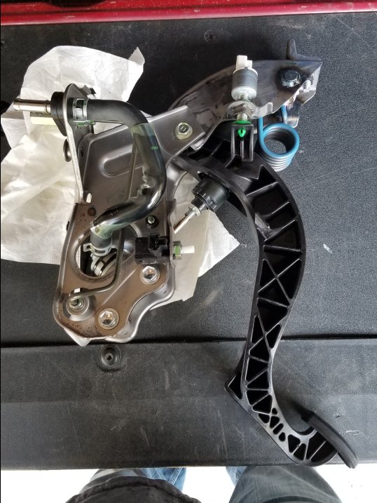

    Sorry, Tony... I completely missed your first question. The pedal feels stiffer, with less wiggle. I really didn't think it would, but it does.
    You could definitely replace just the pedal. In fact, I was going to ask @su.b.rat is there was any difference between the master cylinder part numbers, but I had already bought the parts, so I just installed them. If the MCs are the same, then there's no reason to go through all of the trouble of removing the entire assembly.

    From what @su.b.rat posted previously, the only change on the M/C is the all metal end on the push rod.

    Here are a couple of photos of the assembly that I didn't post. Maybe they'll help.

    One more stupid question. The rubber pad on the pedal. Can you reuse it or did you replace it?

    The MC I ordered came with a metal adjuster on it, but the parts list I went off of also included a part number
    for another metal adjuster, so I ended up with two. The additional adjuster was a *tiny* bit different than the adjuster
    included with the MC I purchased, so I used that one.

    Reused it.

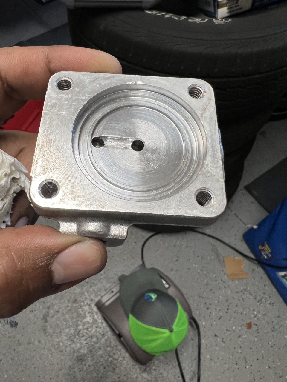

    Thanks to OP and everyone that posted on this thread. I ordered the Honda line, but delivery is running late, so I decided to go the dremmel route. Less than an hour worth of work, but my long skinny fingers did help with that top bolt on the cover closest to the exhaust hanger. I had no idea this was a thing on tacomas and was frustrated at how inconsistent my driving was.
