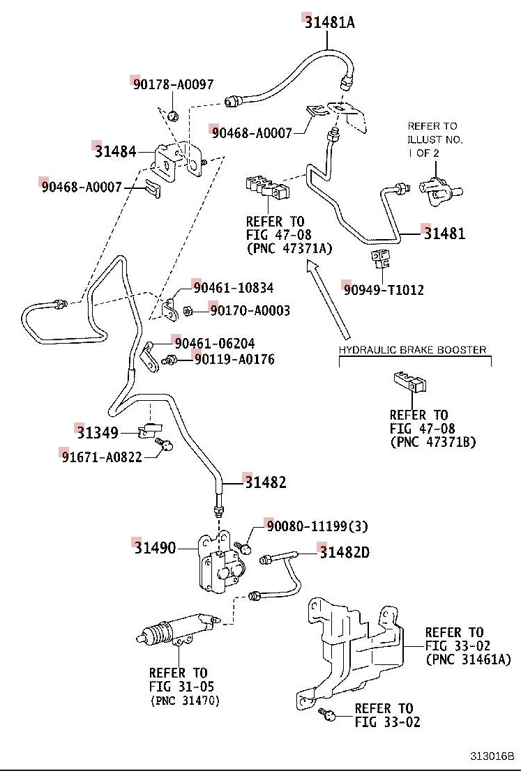

    I believe it can only be purchased as a complete unit with the accumulator. It used to be a little over $100 a few years back.

    The hardline is cheap and was much easier to bend than I expected. If I get board, I may mill my accumulator and swap back just because. But at 90 cheaper for the hardline, I would have a really hard time justifying buying a second accumulator.
    That said, the hardline is not as clean as milling the accumulator, mine makes it a little hard to get to the slave bleed nipple.
