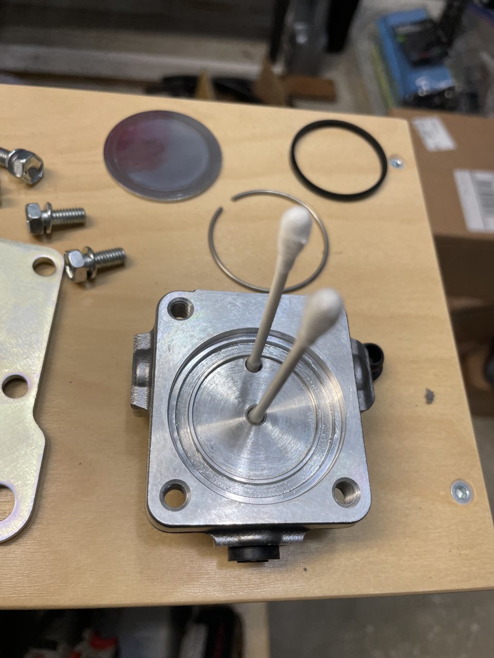

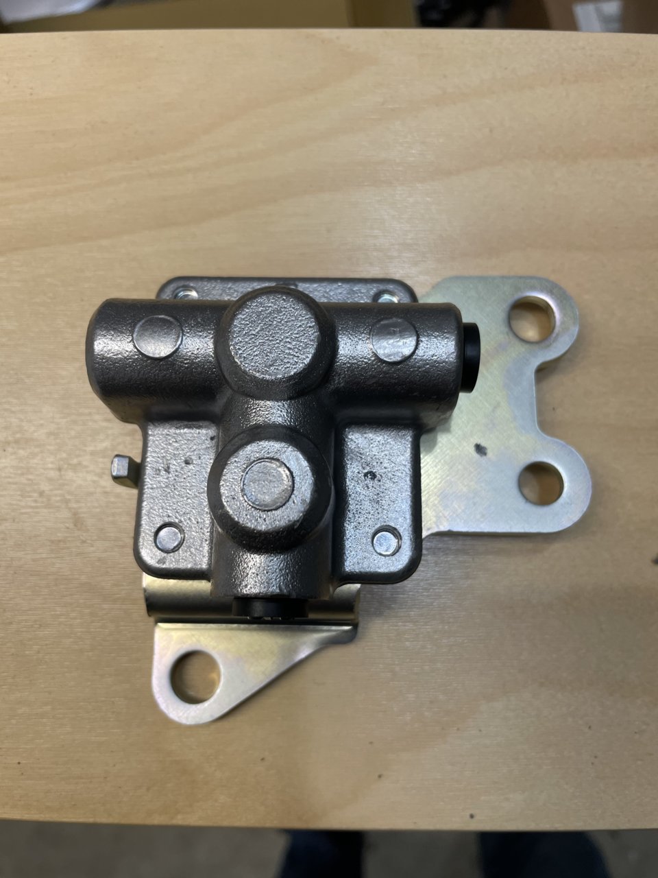

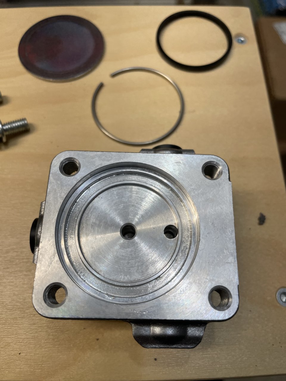

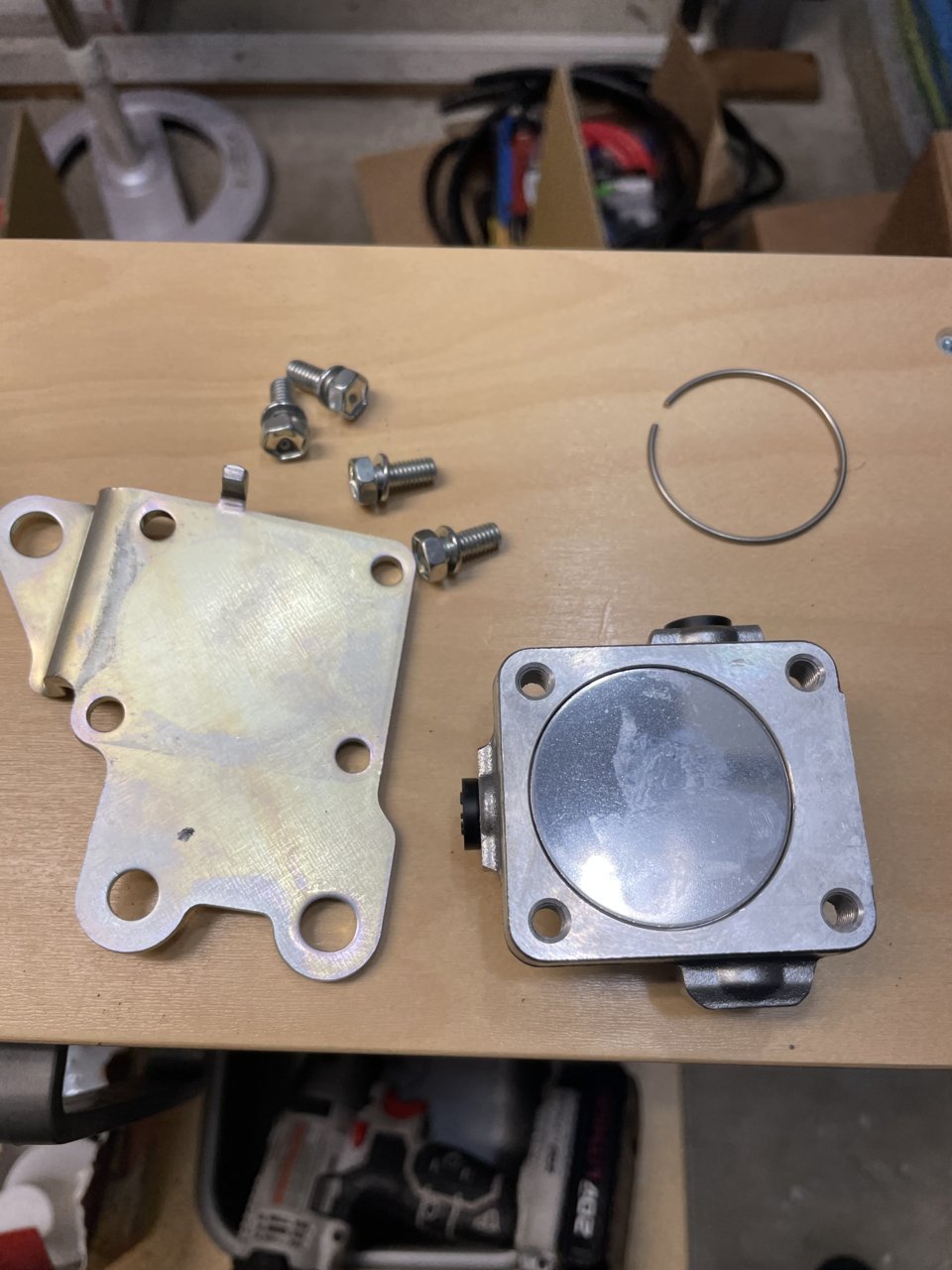

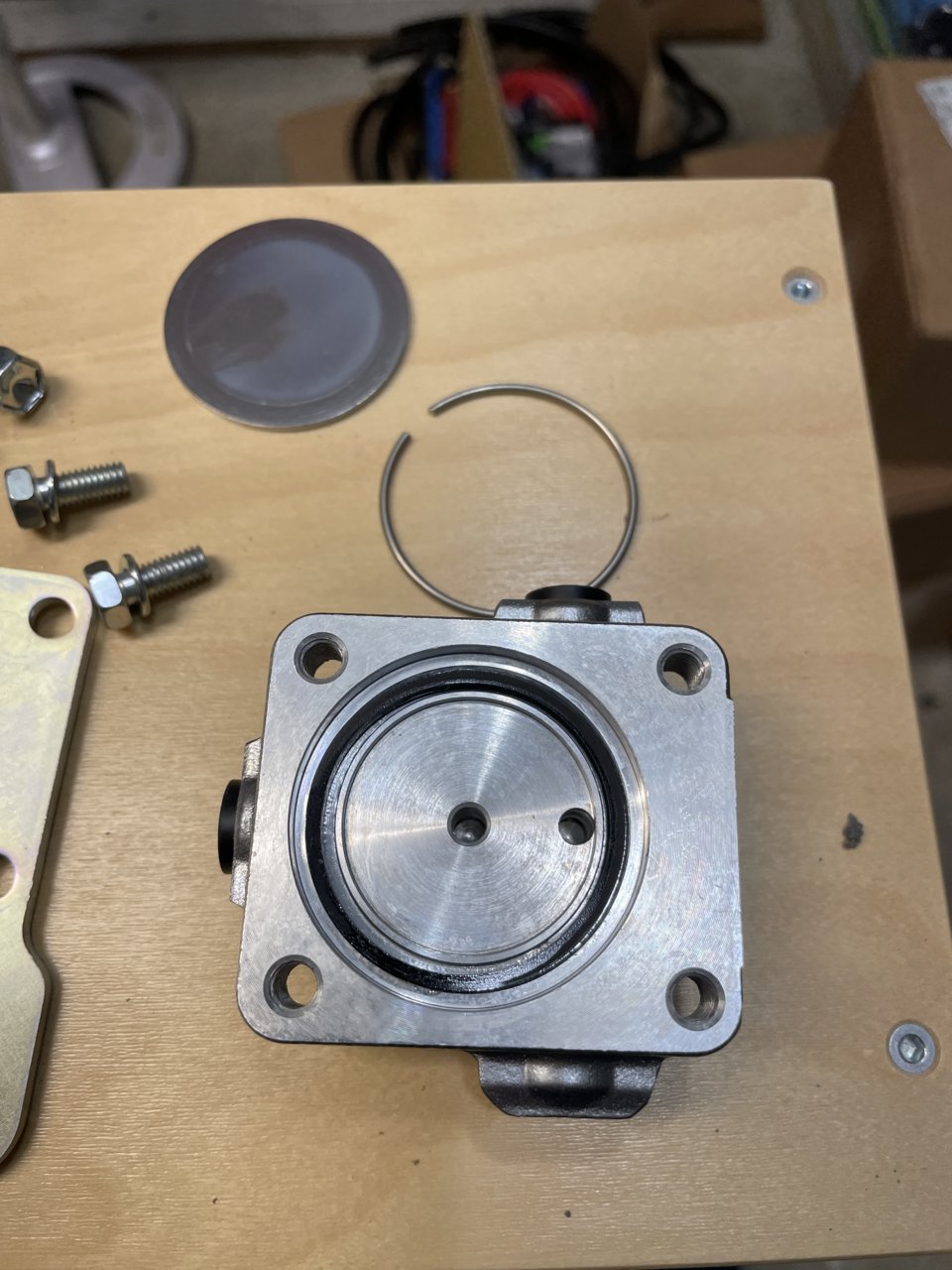

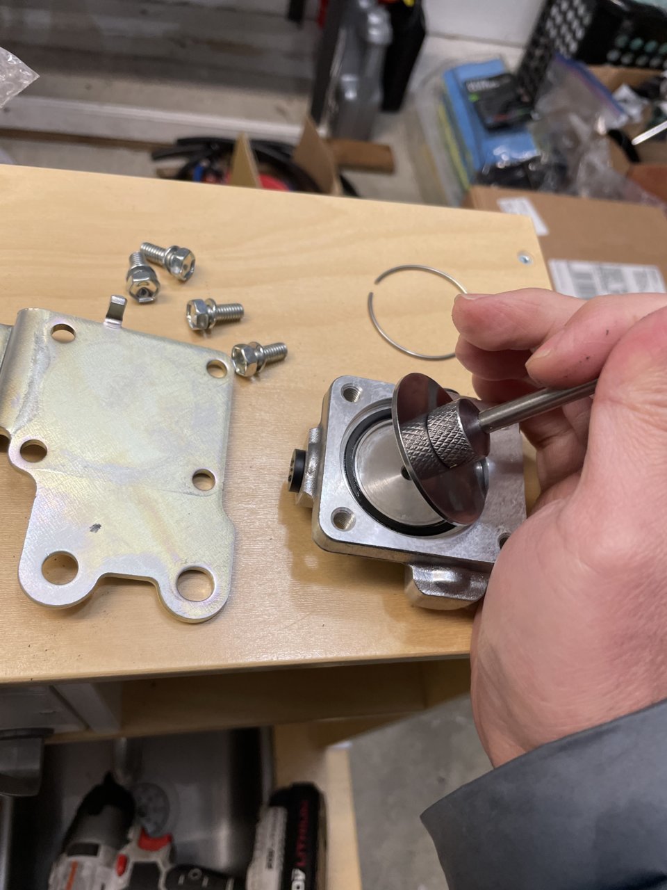

    There are lots of shots of what the accumulator is supposed to look like after the dremmel but not much of what the process looks like from disassembly. The following pics may help folks visualize what needs to be done. The unit comes from the factory fully assembled. Once you get the four 10 mm bolts undone the little pressure plate is magnetic so use a magnet to remove it if it doesn’t come out with a few shakes. Remove the metal ring and gasket. Can place some qtips in the holes and cut off the ends prior to dremmel to stop shavings from getting in the holes or you can just rinse the unit afterword using the line holes on the sides. Just remove the rubber grommets.
    Of note, be careful of the aluminum ring that touches the most lateral hole. You don’t want to dremmel through that ring. A full uncut qtip in the lateral hole provides some insurance as a bump stop. If I were to do it again, I’d leave the qtip uncut in the lateral hole and nothing in the center hole. Just rinse everything well after.
    Per @tonered the depth of the trough you create should ideally be approximately the diameter of the holes you’re joining.

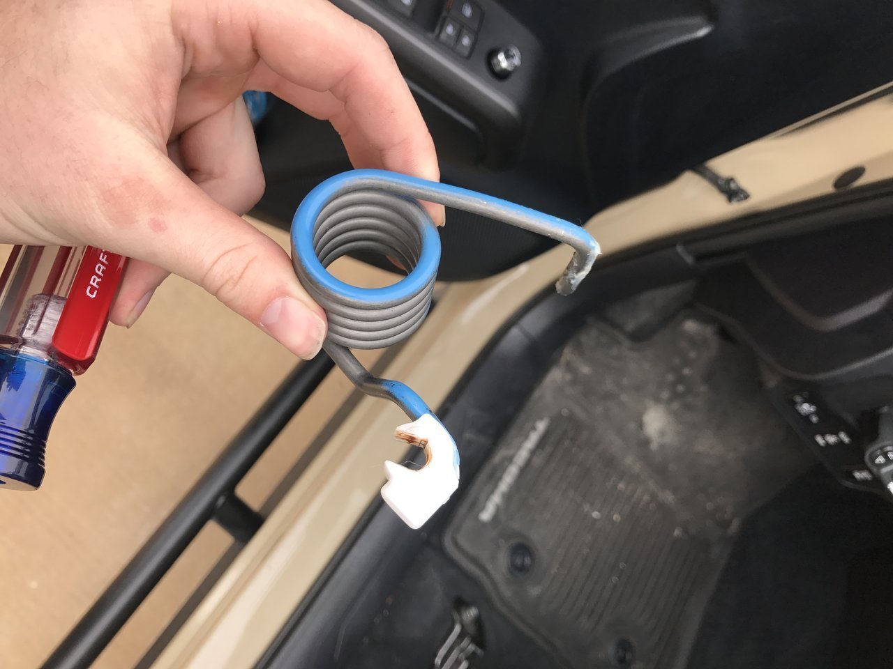

    If you do that then you need some sort of smaller spring to pull the mc all the way back out. It's a bypass port of some kind that has something to do with relieving pressure.
    I believe that spring is called a break over spring and will actually make pedal effort easier past a certain point (while holding the clutch on the floor) but helps to pull the pedal up prior to that point

    That’s what I gathered from that thread as people were saying that the pedal is much firmer, and a little further in after the spring is removed.
    I’d still like to hear if anyone has done this and their overall impressions over a long period of time + if there’s been any issues or anything like that.
