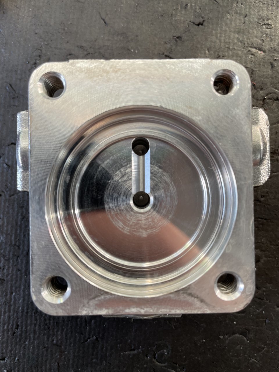

    milled and back together for install tomorrow (maybe). I will have my stock off the truck and can have it milled to send to someone else if wanted or can send it to start the list of modded accumulators.

    Looks excellent. :cheers:

    If you don’t have access/skill to use a mill, there are options - you can drill a series of holes the correct depth and diameter, that just touch each other (this is a more controlled method of removing material at a depth) then finish the remaining material with the Dremel. Take lite, small cuts to reduce the chance of the cutter “running” on you. You should also make the Dremel cuts so if it does run, it does not damage a critical surface. The faster RPM you run the Dremel, the less chance it will bite and run, keep the cutter flutes clean with WD-40 or cutting oil. If you still don’t trust yourself, you can add layers of tape where you don’t want to remove material. I would suggest you wear gloves - that cutter will remove just about anything you push it against. Try it on a piece of scrap, try something new, you might just impress yourself!
