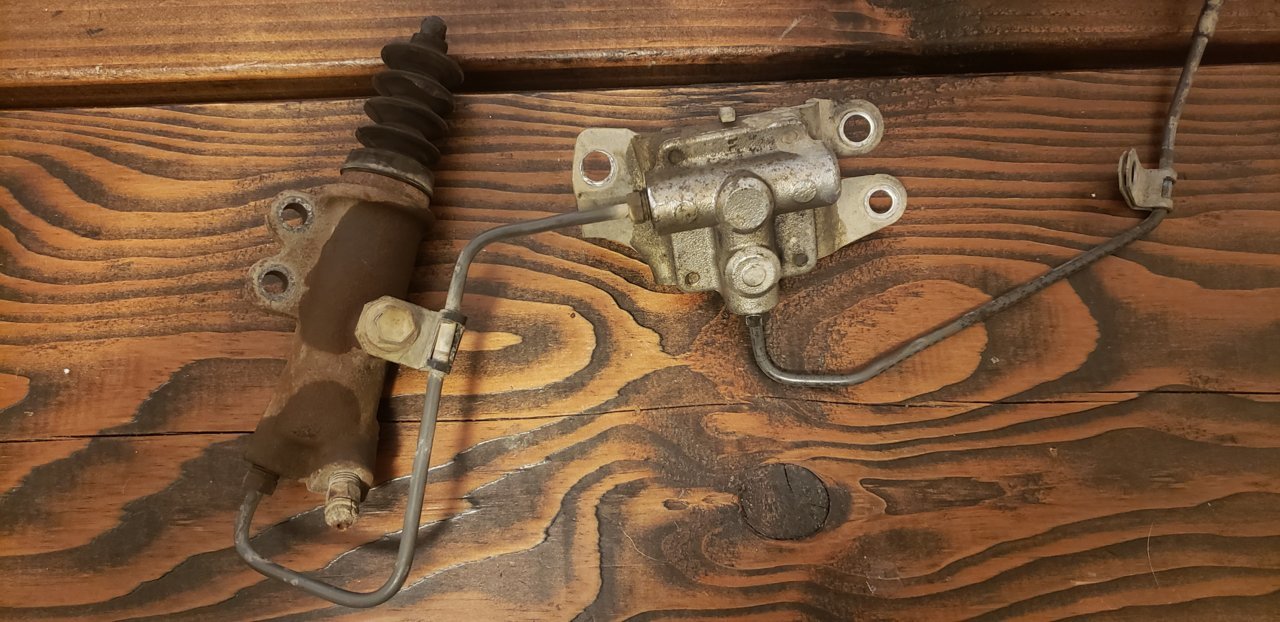

    My understanding is that removing the acc, milling, and replacing is the easiest and cheapest route, and also ensures the connects are solid.
    Sending out for a milled acc is what, $130(?), and also would ensure solid factory connections.
    The bypass line is inexpensive, risks improper non-factory connections, but is the most cost effective risk to take.

    All methods are equivalent. I like the dremel mod because it is quick with no guess work. Hit it, clean it, and install it.
    Milling is a great option if you don't want to use a dremel.

    I agree, but note that when @Trident904 was making this hard line kits, he sourced a particular flare fitting for the slave connection. The down side there was that it was an 11mm hex. Although, that extra meat on it allowed folks to use an 11mm box end wrench, gently.

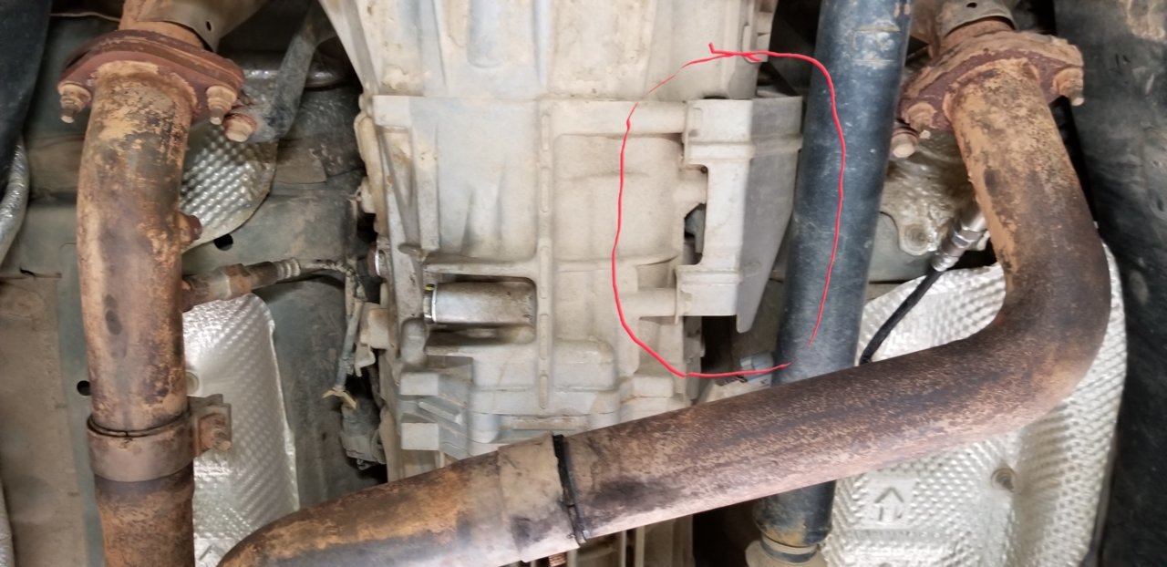

    So is the area circled in red where the accumulator is located? Its covered up by a heat shield and I can't really see much behind it.

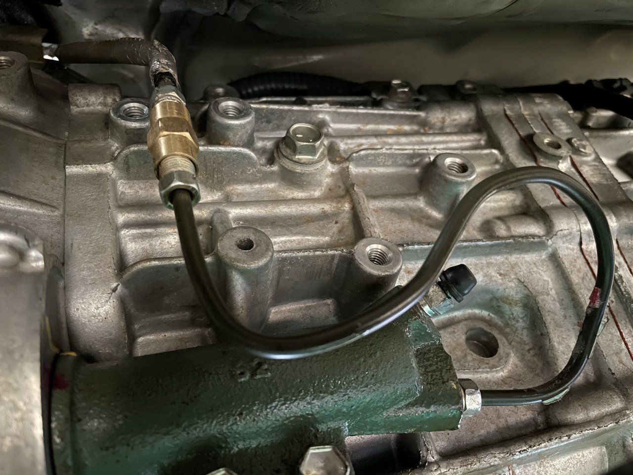

    I did the accumulator delete today after work today.....wow what a difference! I have to say, what the hell was Toyota thinking by putting that crap on these trucks?! It shifts so smooth now! I used the Techna-Fit Stainless Steel Clutch Line.

    The Techna-Fit line works great. It is a little difficult getting tools to fit in that tight of an area. Flex-head line wrenches worked really well. The clutch was easy to bleed out also. The whole job only took me about an hour.

    Working on mine now. A few things to consider:
    - the upper front bolt of the acc is a PITA and is better removed if you yank the cat support bracket before to attempt to remove the acc
    - you'll want to unbolt whatever wiring harness is to the rear for added room.
    - there's going to be about 4oz of fluid coming out of the acc when you unscrew the tubing, didn't expect that
    - you'll need to be conservative with the small, $4 bottle of Dot3, esp if you're doing the solo bottle method to bleed. If you bought the 32oz bottle, no worries.
    - I bought the prefab 12" brake line. All parts, fluid, and even pliers to bend the tube cost me $25 at Autozone
    I'll let y'all know if I f'd it up tomorrow when I test.
