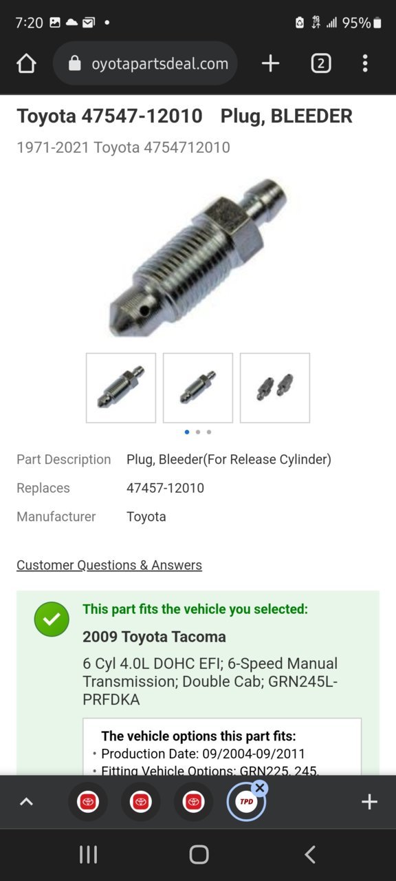

    Does anyone know the size of the bleeder on the slave cylinder? I did the dremel mod today and I need to replace the bleeder.
    I tried searching but couldn't find anything
    I'm guessing it's a M10 but that's about all I found so far.

    It is not M10 as it uses a 10mm wrench to fasten it. Likely an M8 thread?

    Just FYI
