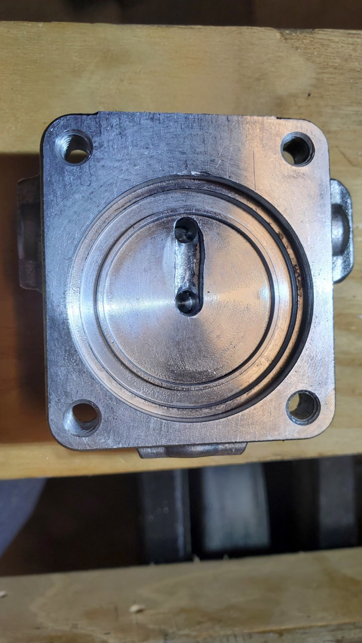

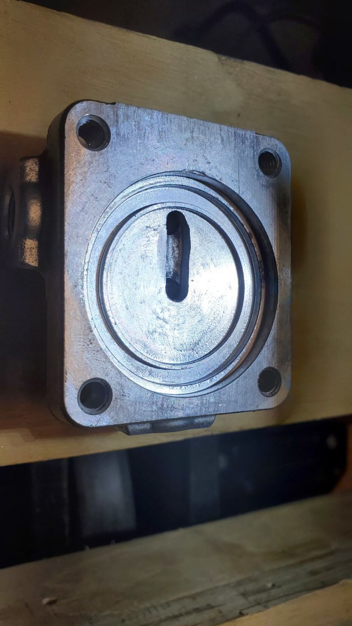

    Finally got this done using a milled out accumulator. It's very subtle, but definitely improves shifting. Gone are pulses & oscillations, overly difficult shifts and inconsistent bite point.

    Another observation:
    While we focus our accumulator hate on the clutch release, I feel there is a significant benefit when engaging the clutch too. I think my shifting has improved and I can now shift more quickly (as done in past vehicles) because the accumulator is not buffering/slowing the engagement side of the clutch either. I'm getting the full engagement of the clutch when I want it while I'm in the process of shifting versus it lagging slightly behind me.

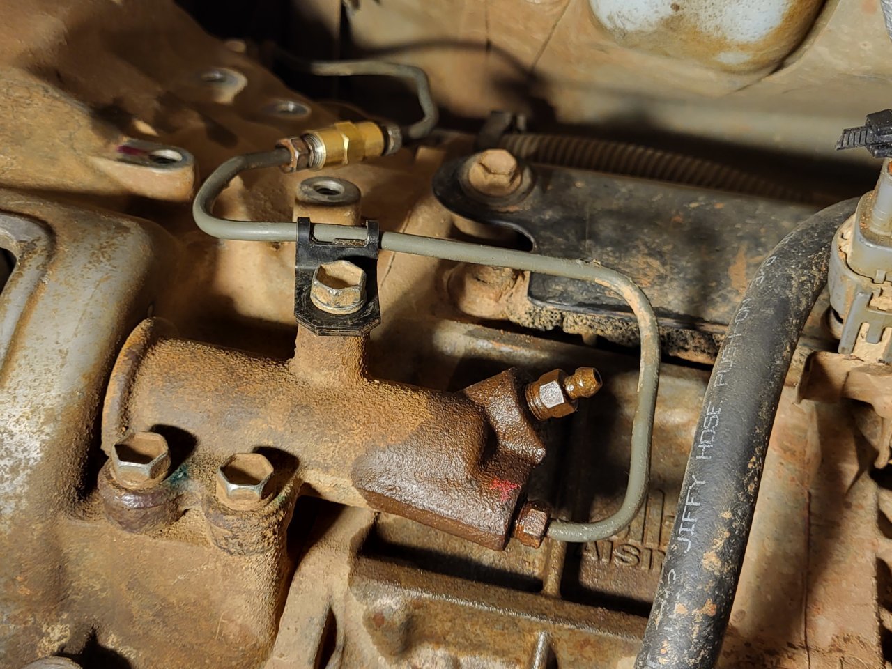

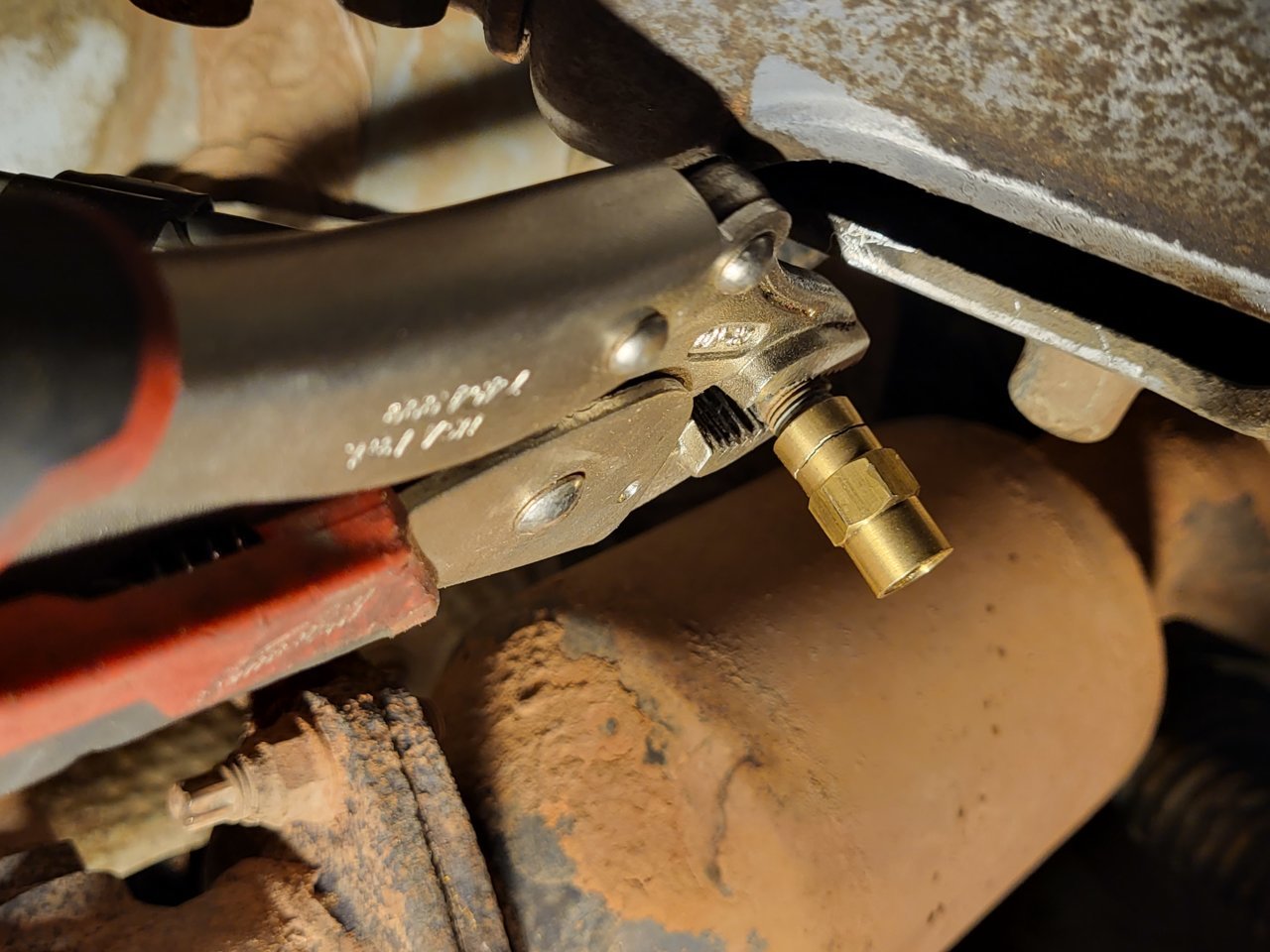

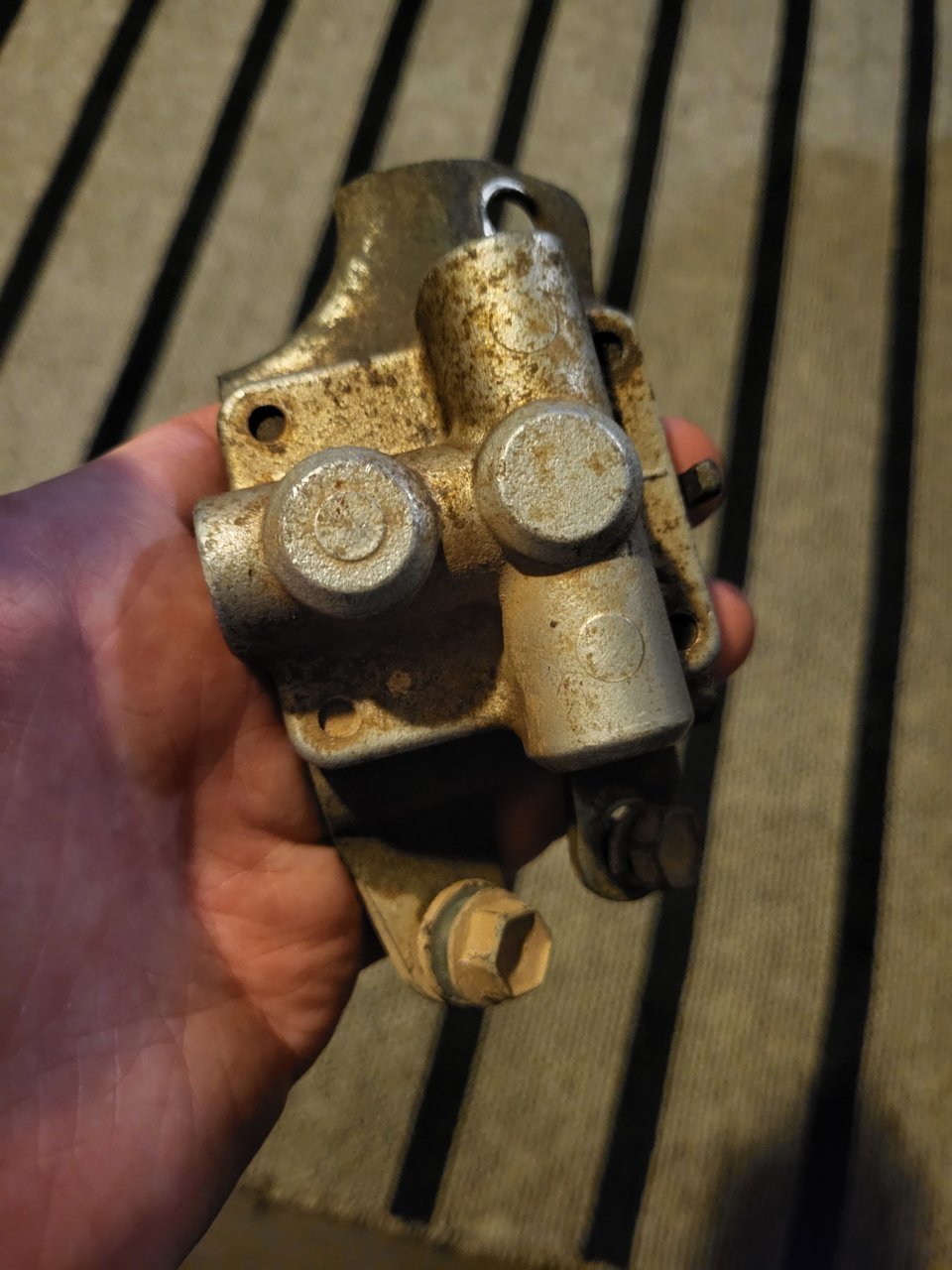

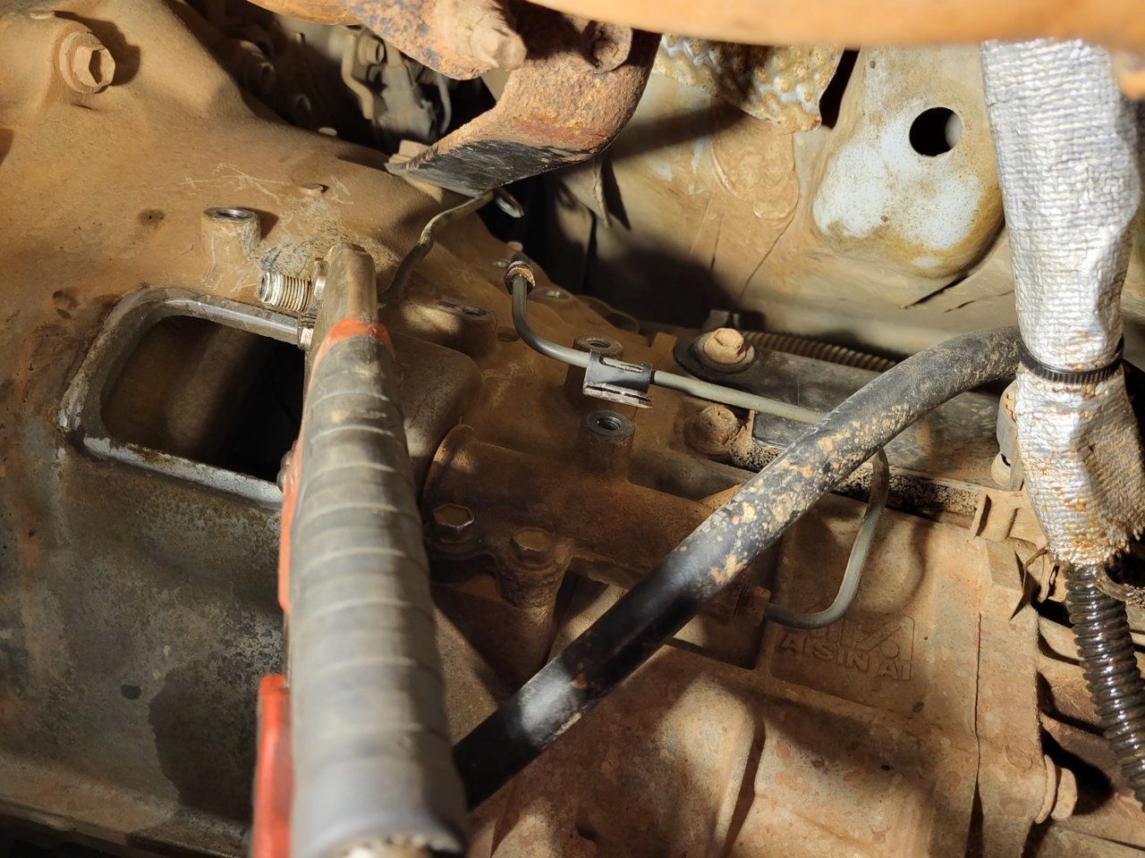

    Did the mod this weekend. It was definitely a struggle to get everything unhooked and put back together.
    I would recommend taking the extra 5 minutes to remove the driveshaft. It is right in the way.
    It would have been nice to have ratcheting tube wrenches as well, most of the bolts are just hard to get to.
    I went with the Dremel method. Mainly to keep it looking OEM.
    Besides the struggle of threading the mounting bolts blindly, I did somehow booger the threads in the accumulator. Had to essentially "retap" them with the hose fittings.
    This might lead me to suggest going with the brake line method.
    Crossing my fingers that it doesn't leak. Its been good so far.
    The most notable difference for me is the shift from 1st to 2nd. It is much improved and has no more clunking. Can shift much faster and smoother. Don't have to hold 1st gear out to keep up with traffic.
    The bite point is more consistent and more defined.
    Still can't figure out why Toyota though it was necessary to add the accumulator.
