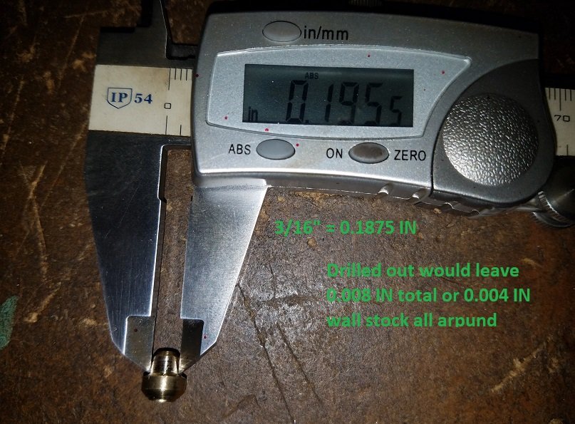

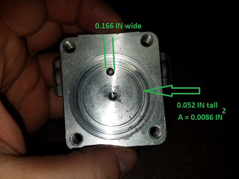

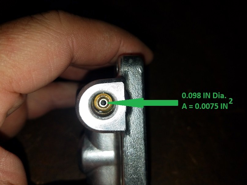

    Long story on the accumulator: It seems to be set up as a flow restrictor, More so than a venturi or weir, which would be a localized restriction. This is a " treacherous path" from the inlet, behind the disc, through the outlet. It has the effect something like a timer.
    It all starts with the inside diameter of the line, 3/16" which has a cross sectional area of 0.02876 square inches. The flow path behind the disc only has a cross sectional area of 0.0086 square inches. Roughly 1/3 the cross sectional area, over a length of about 1/2", (center to center of the holes). 20181105_092224.jpg

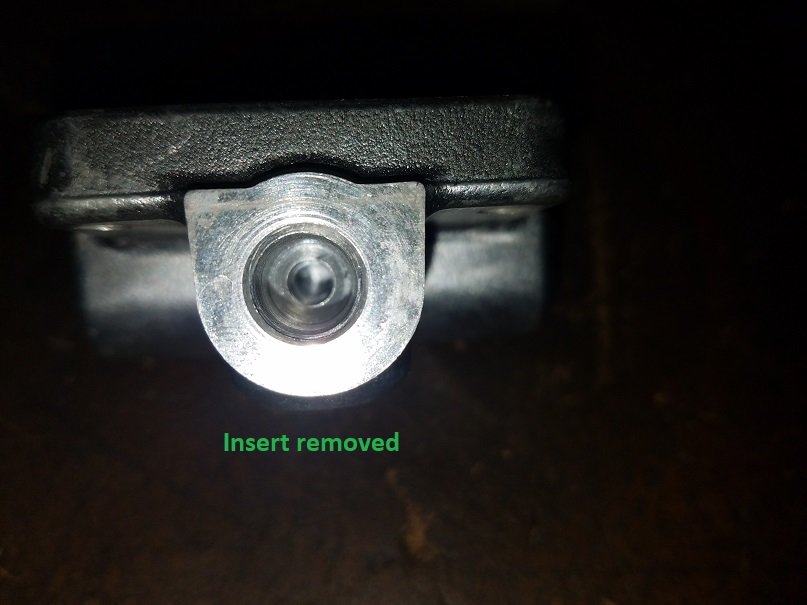

    A trough could be machine to connect these two ports, that would increase the area and help. But there are also restrictions in the flared seats. These have similar reduction to the cross sectional area of the flow path.
    20181105_092220.jpg I tried to drill one out to 3/16", and the brass caught on the drill bit and pulled out showing the next problem.20181105_092329.jpg 20181105_092237.jpg
    There is not enough material to drill out the insert and then press back into the housing to re-use the seat.
    The press fit bore in the casting would have to be opened up and a new flare seat fabricated and press back into place.
    Again, not impossible, just not worth the trouble, in my opinion.
