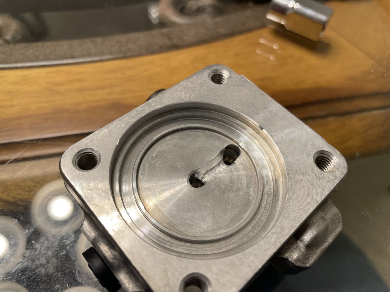

    Did the dremel mod yesterday on an accumulator I bought at the dealer, and installed today. Not the worst install ever, but definitely not fun. The brake line fitting threads applied enough pressure on the accumulator ports that I could not unthread the fittings by hands, which meant a thousand cycles of spinning the wrench a bit, lifting, rotating, setting and spinning again. Probably took me an hour just to get the thing out.
    When I installed the new one, I had no trouble. Held the accumulator up there, threaded the fittings by hand, bolted to the transmission and then snugged the fittings. I’m pretty sure the problem with removal was I still had the accumulator bolted to the transmission while I was unthreading the lines. This held the accumulator in a tighter spot putting more preload on the lines which put pressure on the fittings and threads, making them hard to unthread with fingers.
    In the future I’d definitely considering pulling the driveshaft. I would highly recommend pulling the exhaust support as well, which I did not and struggled because of it.
    definitely need a ratcheting box wrench (12mm) for the heat shield bolts (especially the top left one) and you also need a 10mm line wrench. A regular wrench is a bad idea on the fluid lines.
    Final thoughts:
    my clutch is now MUCH softer. It’s not necessarily bad, just different. I’ll probably get used to it just fine. I am wondering if I still have air but I bled probably 13 or so times and had no air coming out so I called it good. The clutch works fine, so I think this is just how it is.
    The engagement is for sure much better. It is a drastic difference. The clutch engages in the exact same spot every time, so I know exactly how to operate the pedal now. It probably does start to engage sooner off the floor than before, but that isn’t bad. Overall I’m happy with it. In a few days after some use I may pop the heat shield off and give it another few bleeds just to see if any residual air wants to come out.
    overall a good mod. Wish Toyota would have just set us up this way to begin with. Thanks @tonered and all contributors for the thread & it’s contents! Glad I went the dremel route over any of the other methods. It just looks much cleaner up there still appearing OEM.

    Ok, after spending more than 20 minutes digging through this thread, can someone please explain the Dremel option in a little bit of detail or point me to a post that talks about it? So, I take the accumulator off, flip it over, and use a Dremel to....???? A little help please :D
  8. Jul 7, 2022 at 2:11 PM
    #2988
    tonered
    tonered [OP] bartheloni
    Sep 25, 2017
    #231055
    31,264
    tony
    Lynnwood, WA
    The first post? There's pics.

    Saw just Dremel it down to when you see those 2 holes or are they drilled?

    Holes are already there, dremel a channel between them.

    What, @BLtheP said. Just cutting a channel for flow. Going down the size of the holes will get 'er done.
