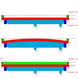

    There can certainly be a negative fluid pressure through a restriction. I am not talking about gases, but the fluid is throttled through the orifices just like any other throttle, with associated losses. If a fluid can have a positive pressure, it can certainly exert a negative pressure. A simple search is there to do.
    You assumed that a stainless steel disk will deflect under a minimum of fluid pressure, but do not believe that a low durometer seal can be compressed on the engagement stroke?
    As a final note, the plain steel backing plate that attaches to the MT is larger and would be under a greater stress if the main disk was deflected on the disengagement stroke, which would be a very likely source for a leak.
    I might buy into some sort of disk deflection if this was the boosted brake system. The clutch is a lightly loaded system with the only pressure applied by relatively weak springs in the clutch.
    You are welcome to try, but I would put money on the proposed double disk solution not changing the feel of the OEM accumulator setup.

    The double disk solution is identical to Firn's machined brass disk but instead of one thicker brass disk there are two disks (one being the original disk) that are equal thickness combined to the brass disk. You accept that Firn's solution works so why won't this?

    Double disk vs modified disk vs Dremel vs hardline
    All else being equal (results).... I would take the route that involves the least amount of pressures. Which rules out the double disk.
    Just a thought.

    Deflection of the disk was my first thoughts as well but after opening the accumulator and seeing how thick and strong the original disk is I think that is unlikely. .
    What I believe is happening is the space between the disk and the center port is just the right distance to use flow itself to create a restriction.
    Ever put your hand over the drain of a bathtub when it's draining a full bath? When you JUST get your hand to the right spot there is a sudden and dramatic increase in the force pulling your hand down. There is an interaction between the flow, the port size, and the space between your hand. I think the factory accumulator operates much the same way. Basically a self limiting flow restriction. At certain flow volumes the flow itself restricts more flow, but by changing the space and angle of the fluid entering the port you break the "hydro-lock" (for lack of a better term) that restricts the flow.

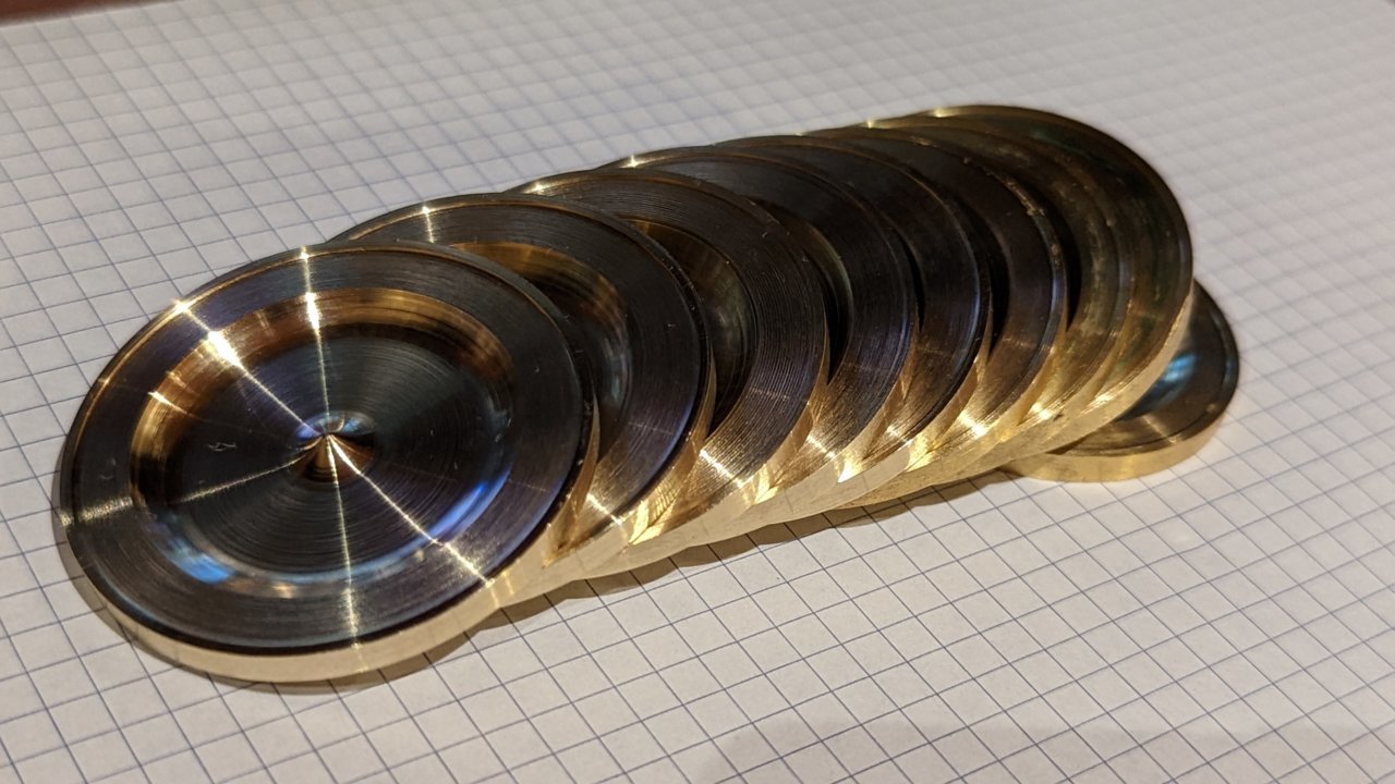

    Spent a few hours tonight trying to improve my process.

    tony
    Lynnwood, WA
    Looking great!
    Nice work.

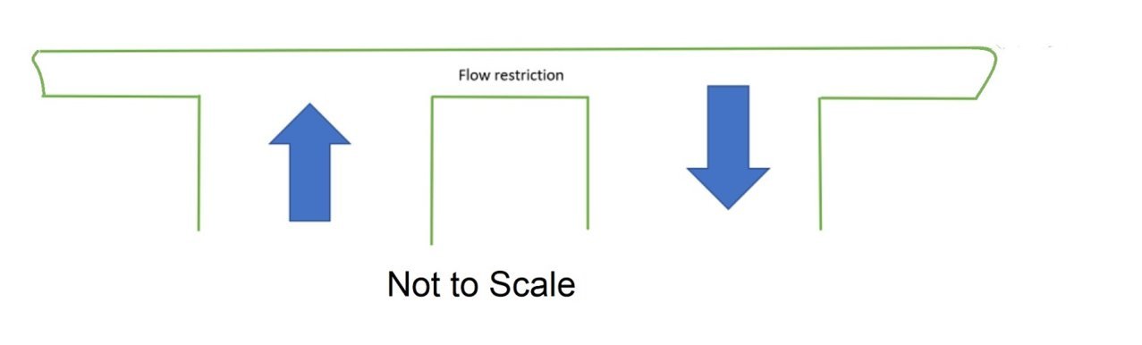

    fatboyfirebass
    fatboyfirebass Well-Known Member
    Mar 24, 2018
    #248258
    1,063
    2018 Blk TRD OR DCSB MT6 Prem/Tech Pkgs
    OV Tuned, S&B Intake, MBRP Dual black Cat-back, accumulator delete, URD SS, 2LM, SSO Hybrid bumper/Warn 10kSynthetic, Custom Car Grille, MESO Ultimate Turn Signal in KTJO Power Folding Mirrors, Genesis Dual Battery, BHLM with LED upgrade, Fog delete, Geko Bed & Underhood lighting, Rear camera anytime, Nav Block Override, 400W anytime w/ interior outlets, USB charging stations, DE-badged, TVD blackout kit, HiLux interior door handles, Hybrid SS/Delrin Shift Knob, Cali-Raised bed Stiffeners, Ultimate Tailgate Seal, "El Dorado" Dual-quad horns, Diamondback HD cover, Mobtown engine/trans skid plates, RCI control arm skids, JLT oil catch can, Meso overhead Hex rack.
    I view it as a "fixed orifice". Based on the idea that the disc does not flex, or only flexes minimally. The distance between the disc and base restricts the amount of fluid flow. The end goal being to regulate flow. So, no mater how fast you press down or let up on the pedal, it would always takes the about the same amount of time to fully release or engage the clutch plate.
    It always seemed an eternity to me, before I bypassed the device.
    Maybe to help drivers new to manual transmissions, or those who have returned after years of autos, to prevent stalling?
    Shellshock and CygnusX191 like this.
