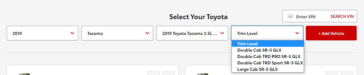

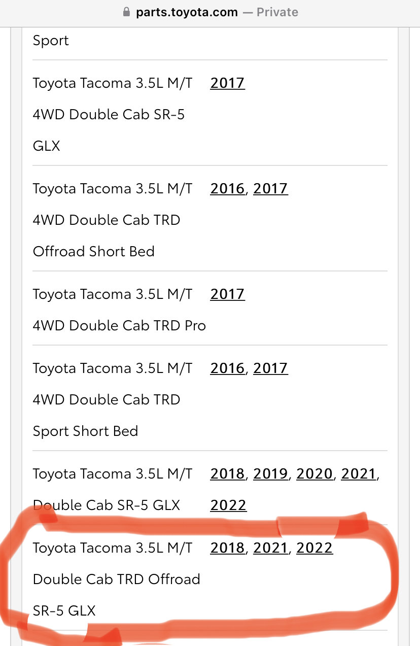

    I would have posted this in the “Buy / Sell” forum but I’m not at 50 posts yet. When I looked up my vehicle it’s saying the accumulator won’t fit. Is there really a difference in years? I have a 2019 OR DCSB M/T

    This is from the website.

    Very interesting and good question. When I looked to see if the accumulator was a different part number the Toyota Parts website does not even LIST the OR as a trim level in 2019 (or 2020).
    I cannot confirm that it will fit that specific model, however I am HIGHLY confident it will. If you do have problems I would happily work with you on it.

    The parts websites for Toyota really suck for filtering by model. I mean, what kind of trim level is "double cab TRD PRO SR-5 GLX"? If you had an SR5, which one would you choose? I've had all sorts of trouble picking parts for my 21 OR. Usually cross reference multiple websites that say "fits" per my VIN until I feel confident enough to buy the part.
    For this specific discussion, I don't think there are any differences on any accumulator from 2016-2023 6 speed manual transmissions.

    Chances Toyota changed something MT related partway through third gen builds then changed it back two years later? 0.000001%? MT is like 3% of total sales? Heck, the clutch start / cancel is still a tall switch, the only one on the truck, necessitating that tall blank for AT’s.

    There are no SR5 MTs. Just the Sport, OR, and Pro have MTs and accumulators. The 2016 and 2017 2.7l SR did not have an accumulator.
    The TRD models are known to be sort of option / trim packages above the SR5.
