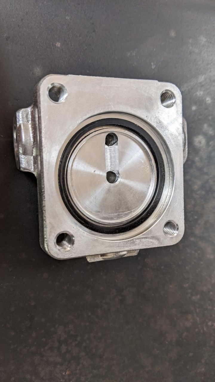

    Just did the mod today. took about an hour and a half only because some of the bolts going back together decided to be difficult. I ended up milling mine only because I have a lathe w/ a mill attachment. Clutch now feels predicable. I give this mod two thumbs up for anyone on the fence.
