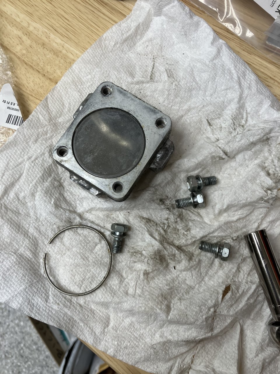

    Not dropping, maybe I need to get it hot?
    guess I left it in a baggie too long?

    I think I literally flipped mine over and it fell out. That is strange.

    Yeah, mine was all crusty, this was one of the first mods when I bought it back at the start of the pandemic, back in the days of Triton the pilot dude. Unpacking my accumulator and it was all crystals of ? salt? Dunno. Likely some sort of corrosion starting up. I could soak it in oil? wd-40?

    #405191
    1,249
    White OR
    Air compressor.
    Plug one port and pressurize the other one.
    Point away from face...

    Maybe a quick, small blast of air into one of the ports would free it up.

    I'd try the air like @Firn and @mtip suggested. Not sure what WD-40 would do to hydraulic fluid. You also probably want to look into getting a new o-ring thats under that plate. I'm guessing that melted/corroded and is what is causing it to stick.

    The crystals are from the old fluid. The accumulator that I got was like that. No issues down the road though.

    A strong magnet works wonders.

    I tried blowing on it, lungs too wimpy I guess.
    This one is off my truck so 2016, sitting in a bag for a while.
    I can hunt for a stronger magnet, weak one didn't pull it. Don't know that I have one though, kids and strong magnets aren't a great combo.

    Mine wouldn't fall out either, I used a magnet (from a stiffy phone mount) and it came right out.

    Toss it in your deep freeze for a few hours.
