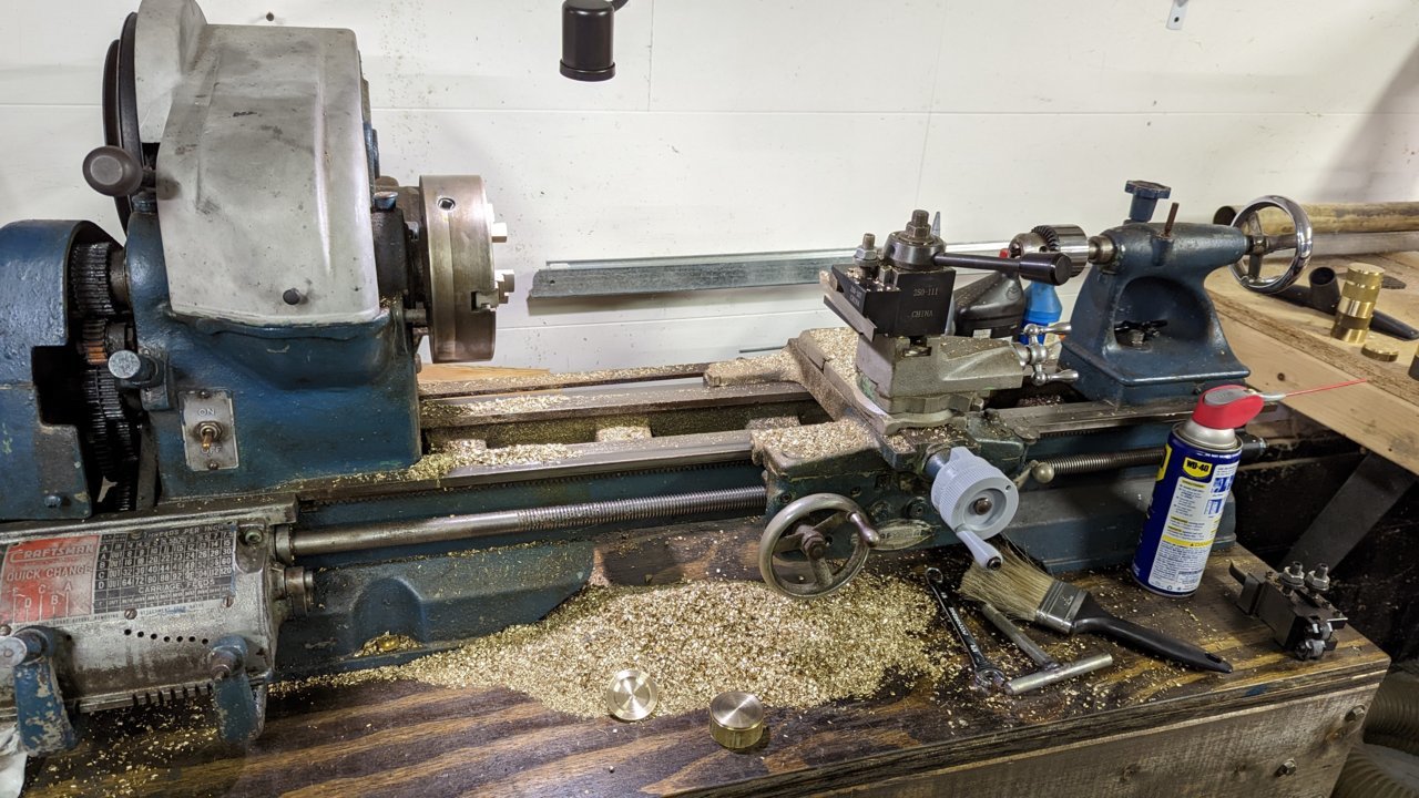

    Here is an insight into the amount of material that comes out as waste when making a batch of disks

    Firn should be President! Thank you Firn for your genius fix. Shame on Toyota for that evil accumulator!
    I've driven manuals since the 80's. I even enjoy driving 'economy' rentals in Europe only because they have manuals. My big goal was to get a Tacoma before they changed it. I ordered (aka: put in for an allocation) in April, 2021 and finally got my '22 TRD Pro in April, 2022. As arduous as the wait it was, I was thankful I got one of the few manuals. That is, until I got it.
    At first I thought it was me because I just sold my 2018 Dodge Challenger with a TREMEC 6 speed and just figured it was car vs. truck. But driving just stunk! I even began considering selling it and buying an automatic (much to my own shame). Then Tacoma World (which helped me through my year long allocation wait) revealed the accumulator story. So I crawled under my Taco and yes, I saw it there. I read up and considered all the various 'fixes' that Tonered laid out for us (Thank you Tonered !). For the reasons others said, I was on the fence about taking a brand new truck apart and 'fixing' it with bypass lines, etc. This went on for about 4 months.
    Then Firn came through with his genius brass disc. I put it in about 2 weeks ago and OMG, its like folks say; Day & Night!!!! I now love driving my Taco, its just like a regular manual now and all the sickening effects of that darn accumulator are GONE. It is unbelievable how much difference that piece makes. We are all just darn lucky that Firn is decent enough to make them for us and offer them up for sale. Thanks again Firn!
    I followed all the hints of the brother Taco post-ers for the install. So as to offer something to the conversation; the only thing I did different is that noticing the trouble some had with working in the tight spaces, particularly the top shield bolt, I had my wife help. Her little hands were perfect for reaching the bolts. I got them loose with the tools and she was able to get them off. Then on reassembly, she got them started and I tightened them. She doesn't know anything about cars, but if you point the spot, she easily got them off/on.
    Thanks again Firn & Tonered. You made my 50k purchase go from cringing drive to super cool!
