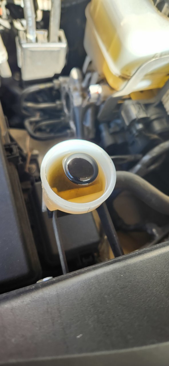

    Working on changing mine out today with the ADM disk, and found this little back thing in the clutch resi. What is it? 20221203_122743.jpg

    Looks like the bottom part of the cap. Also that fluid is starting to get dark. If it's been over 2 years since you've drained and refilled it, get to it.

    Not sure what that was but my truck has it too.
