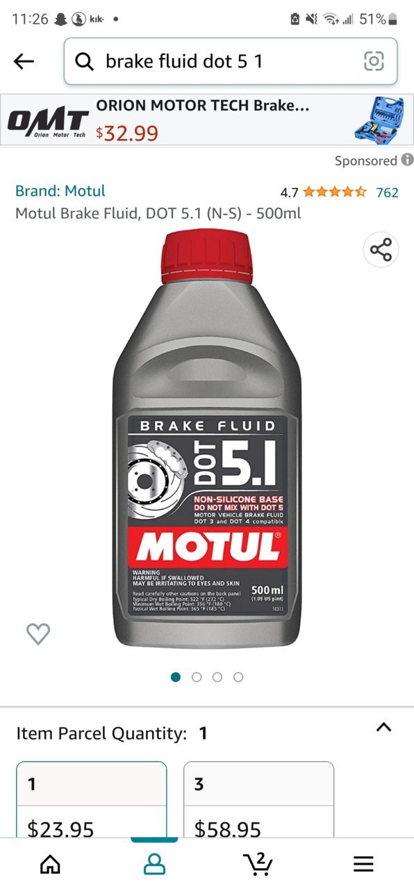

    I used lv brake fluid. Honestly maybe a little less stiff in the winter but hard to tell without a side by side comparison back to back

    i run this stuff in my 6mt corolla and theres a massive difference in the winter time. i will be using this in my tacoma when i get around to doin adm
