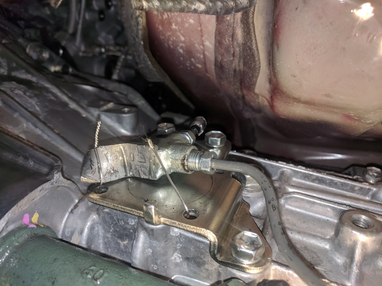

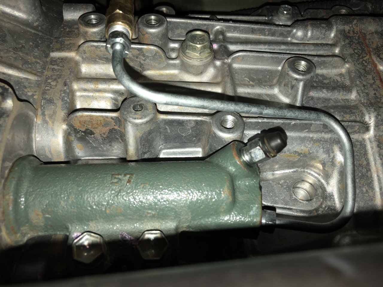

    This (mine / same as @RedBeard1 ):
    Versus this (@Vitalzone 's):
    https://www.tacomaworld.com/threads/mt-accumulator-delete-and-bs-thread.568303/page-14#post-18976661
    I'd say that the second is cleaner. You just need to have some pre-made line (12in), or access to salvage lines and a double flaring tool, and a double female coupler.
    The elbow costs a bit more whether you pick it up at your dealer or order it online with shipping. I would add a clamp to support line, IMHO.
    As I said in the post you quoted, I think the elbow is the most difficult? It definitely works though.

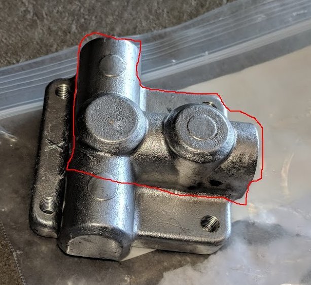

    Anyone who has done this on a gen 2 think you could reuse the valve, but just drill out the insides ? Seems like a drill press could hollow this thing out and leave the threads intact. IMG_20180916_114112.jpg

    tony
    Lynnwood, WA
    That is the problem that was noted. The seats for the lines would get too thin and possibly collapse. That would not solve the real issue on the back side where you need to channel out the flow restriction.
    With all that, the easier job is just to swap in a 12in prefab line with a coupler.

    Sorry. Due to the detail machining needed, a drop in replacement is not feasible. The best route is a prefabbed 12in line and coupler. You just need to do some gentle forming (a 90deg and something a bit more open than 180deg).

    Toyota OEM Brake line elbow with a new or modified bracket welded to it has been working beautifully for me for over a year now. Honestly one of the best mods I have made to the truck. It is a nearly free part at most wrecking yards or you can order a new one from Toyota.

    :thumbsup: Those are some nice clean bends from @Vitalzone... he could totally sell me a pre-bent kit if he wanted to. :spending:
