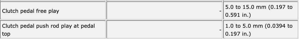

    Sorry - Is something wrong with the master cylinder adjustment? It was definitely adjustable on my 2nd gen. You can put the friction point wherever you want. Just get down there and twist the thing and move your friction point wherever you want. No total system disassembly or bleeding required.

    Typically you still avoid letting the pushrod and pedal make contact at rest, so as long as there's freeplay in the pedal before it contacts the pushrod, I imagine you wouldn't have to worry about the clutch being constantly engaged. There are links to the service manual here:
    https://www.tacomaworld.com/threads/3rd-gen-diy-maintenance-quick-reference.406712/
    Page 1882 has the clutch pedal adjustment. You'll see it not only specifies the freeplay range but also the pedal height from floor range. As long as you generally obey those I would imagine there's no risk of leaving the clutch permanently engaged.

    Thanks. I got under the dash to take a look at it. How in the world do you loosen that lock nut on the pushrod? I can barely get my hand behind the pedal much less two wrenches...

    I really don't want to comment about this, but I think it has to be said.
    I'd love to explain it in detail, but I think you folks will eventually find out that there is no significant adjustment for our clutch.
    In simple terms, you can attempt to lower the pedal height, but it will reduce throw. The situation is identical to lifts for our IFS. There is a set amount to give and no more.
