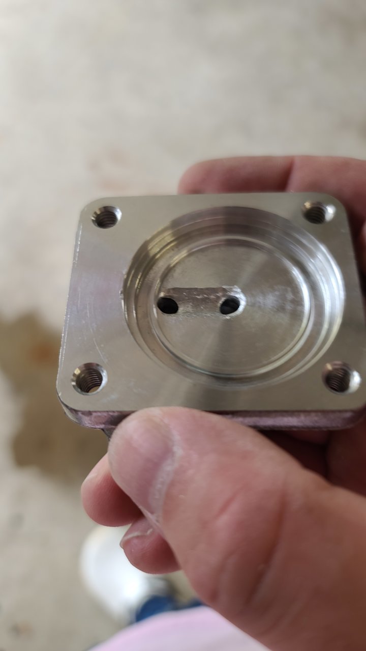

    Add me to the list, I took the Dremel method. Didn't clamp the line from the reservoir good enough dumped all the fluid and still had no issue bleeding the system. It's much better now, no more pulsing when easing off the clutch I'm very happy. 20230821_131946.jpg
