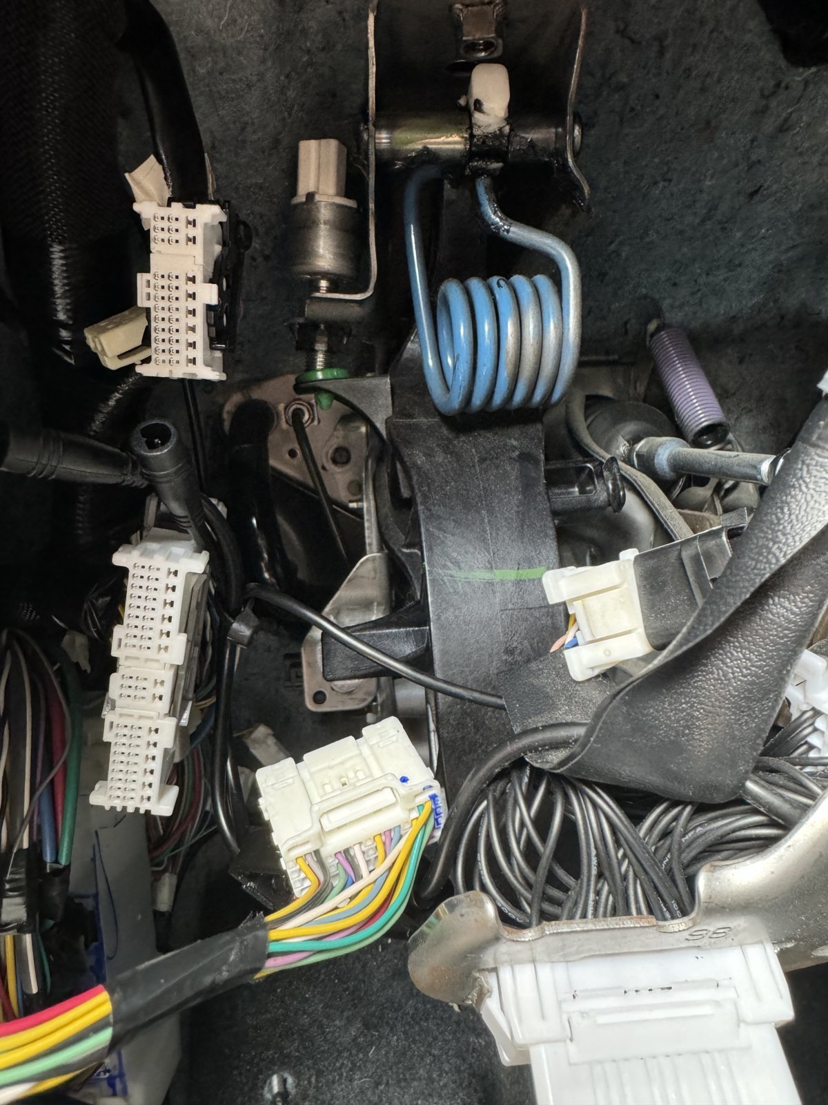

    I took off from work today, tomorrow and Monday in order to have a 5-day break so I could do some stuff on my truck, jeep, and clean my horribly cluttered garage. I finished up what I wanted to do in the garage for the day, so out of boredom I started looking into finally installing the FJ clutch pedal that I bought all the parts for from @Grossomotto back in April.
    Unfortunately for me, I share a house with my brother. When I received all the parts, I opened them up and set them out to make sure I had everything I needed. I got sidetracked and never put them back up. My brother, in an attempt to clean that area while I was gone, cleaned up trash and threw the parts back in the box. A few of the very small parts must have been overlooked as part of trash cleanup because they ain’t in the box. I got all the way down to the pedal swapping itself and realized a few key parts for the clevis were missing. Working on ordering those and then I’ll finally complete the swap again.
    I removed the lower steering column trim panel and then removed the main body ECU. All the horrible experiences @ShirtTucker had were not experienced by doing it that way. It added some steps, but ultimately I think it was easier than trying to lay on the floor and undo all the nuts and bolts blindly. I literally had a straight shot to everything with the MBECU out of the way.
    Will write up a formal thread when it’s all done! Bummer I wasted the day but at least I learned how it goes on a practice run.

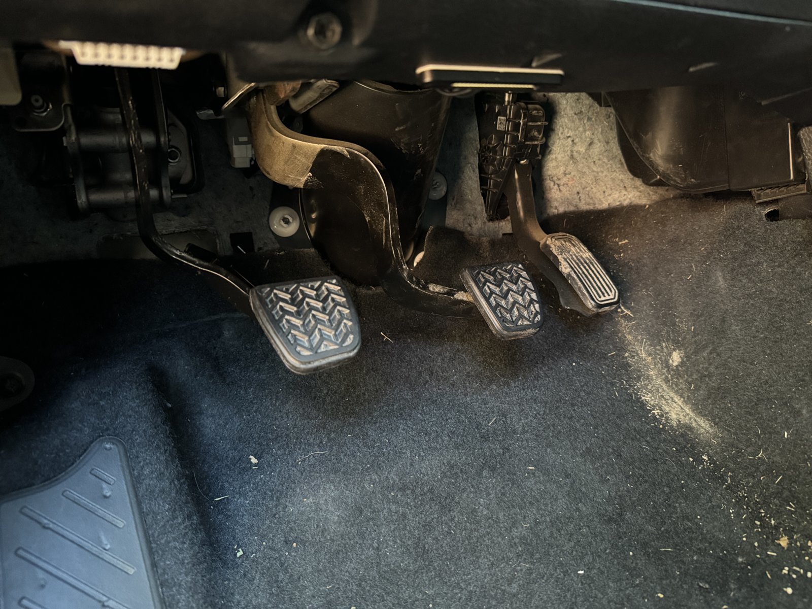

    Does the pedal/MC swap help to do anything regarding the engagement point of the clutch?
    CygnusX191 likes this.
  8. Oct 15, 2023 at 3:07 PM
    #3428
    BLtheP
    BLtheP Constantly Tinkering Member
    Apr 5, 2022
    #394355
    4,654
    Plano, TX
    2021 MGM TRD On-Road DCSB MT
    RC60F Transmission ADD delete with FJ full-time tube FJ Metal Clutch Pedal OEM Mexico-Spec Condenser Fan 265/70R16 Michelin Defender LTX M/S 2 OEM 1-Piece Lug Nuts Custom Built Switch Panel for all Electrical Accessories Rigid Amber Pro D-SS Ditch Lights Rigid 30" SAE High Beam Driving Light Bar Rigid SR-Q Pro Back-Up Light Kit (Recessed) VLEDS Tail Conversion VLEDS Foot Well Light Kit KC HiLites Cyclone V2 Under Hood Lights Operable (Switched) Clutch Safety Bypass
    Nah, doesn’t really change. The new pedal uses almost an identical master cylinder as before. Pretty sure they are the exact same master cylinder, just one of them has a very slightly longer pushrod than the other. I imagine the internals are 100% identical.
    I do think the pedal height could be adjusted downward to where it’s even with the brake pedal that might make the truck feel more normal. And in doing that, you’d have to adjust the clevis down on the MC a bit to match, which would bring the engagement point a bit closer to the floor. I’m pretty sure there would still be more than plenty clutch release with the shortened distance from floor to engagement.
    I’m guessing you want the engagement sooner?
    the adjustments I’m talking about could be made on both stock and FJ pedals though. Cruise control switch controls the pedal height when pedal is fully out, adjusting the clevis on the pushrod affects the engagement. If you adjusted the cruise switch to stop the pedal sooner, you’d need to correspondingly adjust the MC clevis in a bit so that the lower pedal isn’t pushing the clutch in at rest. Doing that would shorten the travel but I think there would still be plenty travel to properly release the clutch.
