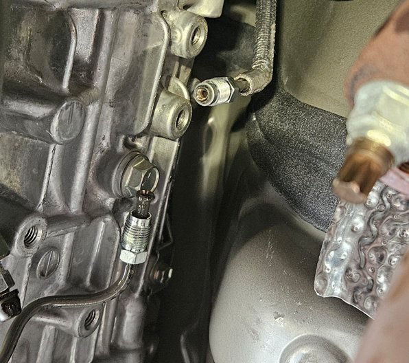

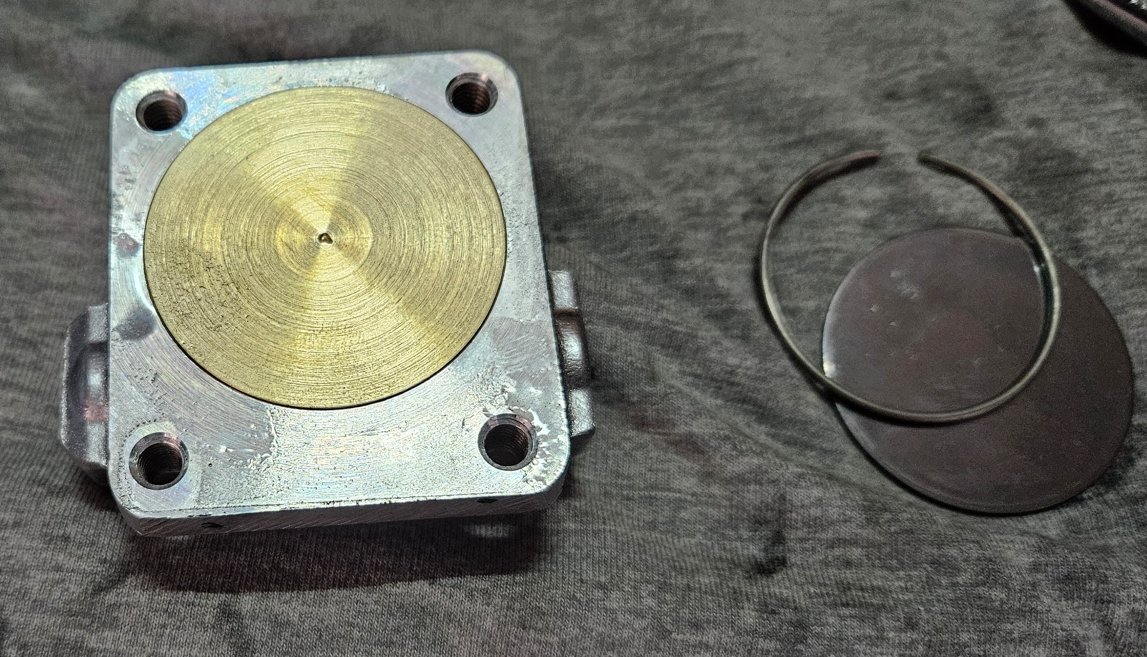

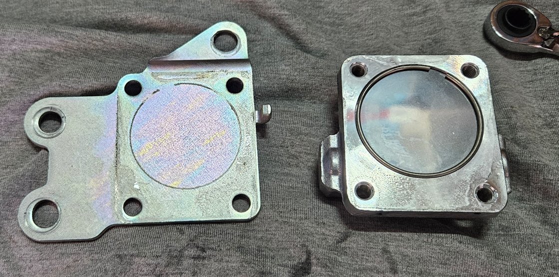

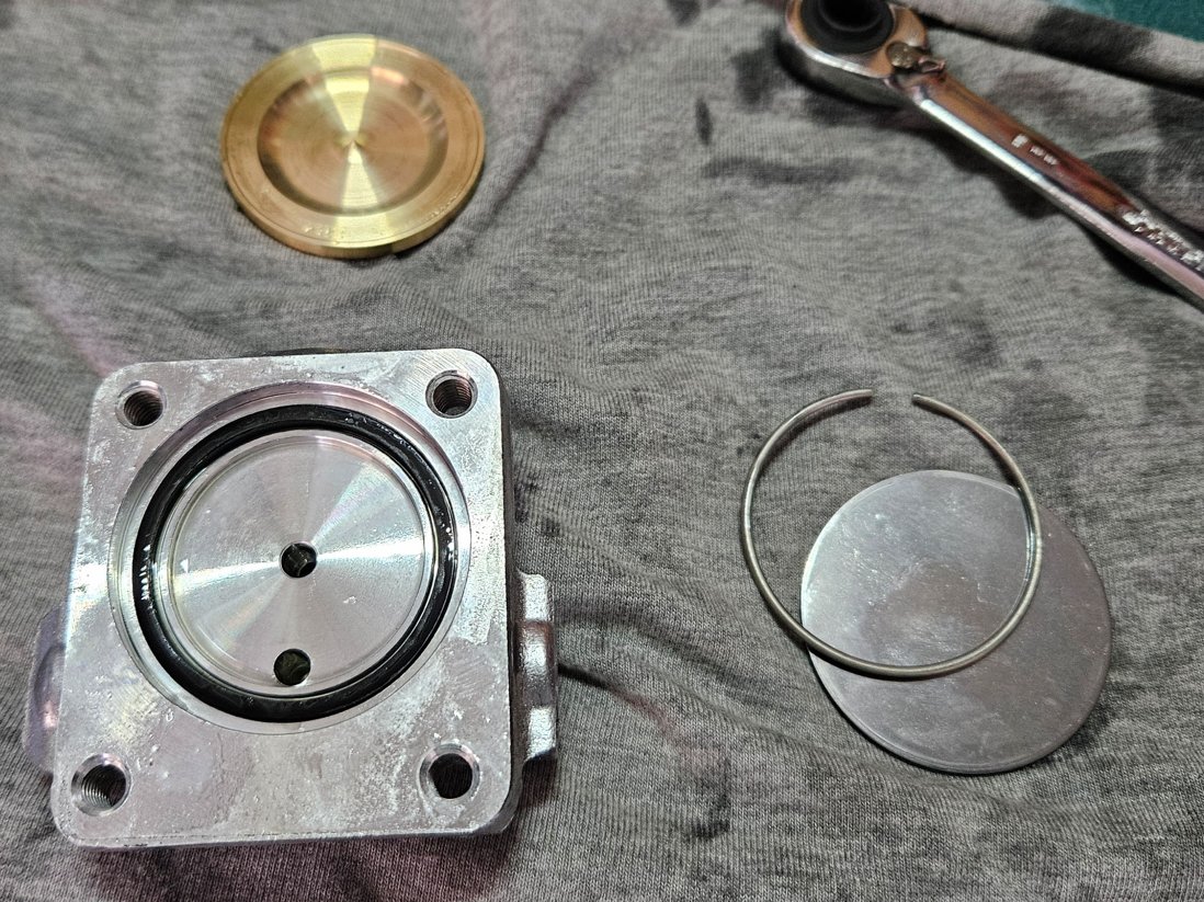

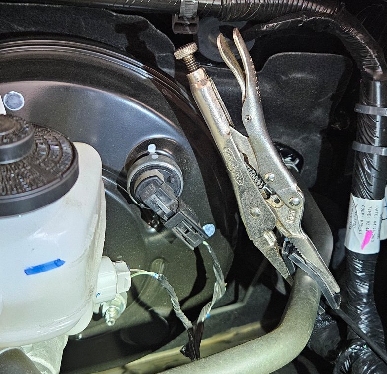

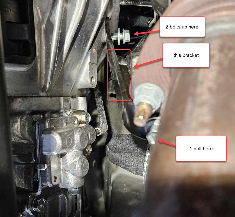

    Finally took the time to do this today. I installed @Firn's delete disk. Thanks @Firn and everyone else who answered my questions beforehand. I wanted to mention a couple things I learned along the way.
    • Removing the support bracket attached to the exhaust gave me a lot more room to work, and removing it was the only way I was able to reconnect the difficult 4th bolt on the shield when I was done. It was a bit difficult to remove, but it made access to the upper hydraulic connection much easier. To remove the upper bolts from the bracket, I used an open-end wrench with a length of pipe slid over it to get some extra leverage.
    • As others have said, clamping off the line in front of the firewall really helped with fluid loss - before bleeding, I only lost a negligible amount of fluid at the accumulator connections. Just make sure you clamp it off with something smooth so it doesn't damage the line. I used needle-nose vise grips with a couple pieces of scrap rubber to protect the line
    • Reconnecting the hydraulic lines to the accumulator proved difficult for me, but I eventually got it. Take your time with these and make sure you get the threads started by hand - this is not something you want to cross thread. Also, if you reconnect these lines first before reinstalling the 3 bolts holding the accumulator body, this will give you a little more wiggle room to get the correct angle.
    Here are some more pics I took along the way.
    Haven't driven much yet, just a quick test drive around the block. Initial impressions are that it was certainly worth it, engagement point feels a lot less sloppy than before.
    Thanks again everyone for all the pointers. :thumbsup:
