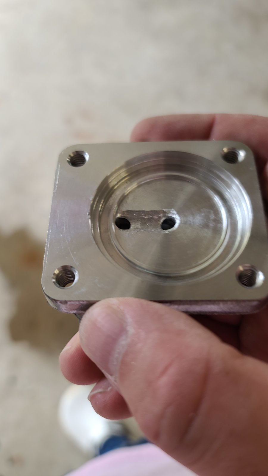

    After trying to remove the accumulator twice, I've given up (tried Liquid Wrench, propane torch, time). Don't want to take the chance of damaging those lines trying to loosen the nuts like shown in the post #3480. I've got no capacity to rebuild those if they snap.
    Not sure if this is kosher with thread rules, but I posted the Firn disc I bought from him on eBay in the TW Buy and Sell (link below).
    https://www.tacomaworld.com/threads...lator-delete-disk-manual-transmission.826121/
    $20 shipped.

    Yea, sounds like the disc might be the way since it sounds like less of a headache. Thanks for the input

    That was an idea, but I don't trust myself enough with a dremel to do that :rofl:Worst case scenario, I'd have the factory/non-modified accumulator if I wanted to revert back.

    Not wrong at all, but more so the case if I did the cheapo o-riley method and messed up, I could at least put the accumulator back and be able to drive :D

    Hey, i will happily sell you a disk, but if you are worried about messing the accumulator up, don't. It's nothing fancy and there is plenty of metal there. You would almost have to try to screw it up to cause a problem.
